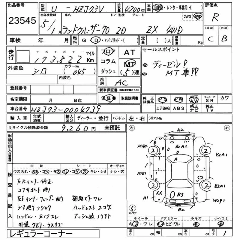

No disclosure for previous wreck and body damage. Previously sold in Japan marked wrecked/repaired, pass side rear quarter and door. Last sold in Japan covered in deep body dents on pass side of hood/fender, pass side rear door, driver side door, driver side quarter, pass side wing fender. This truck has been repaired and repainted multiple times.

Definitely noticed that one while searching around. Thanks for taking the time to do these, crazy they don't disclose a history such as that, especially considering the price they are asking for it. Just out of curiosity, when something is marked as "wrecked/repaired", how bad is that sort of damage? I assume it's more than a fender bender.
Thanks for your comments!
Wrecked/Repaired can mean a lot of different things. In theory, there are degrees of wreck/repair damage. We might see ratings such as R, RA, RB, R1, R2, R3, all meant to denote the degree of damage. However, it's a bit subjective between each auction house and even between inspectors. I always joke that "wrecked/repaired" could be mean "minor fender bender" or "cut in half by the bullet train". Because we don't know which, LCD never buys anything with any kind of wrecked/repaired history. This truck has been through the auctions multiple times, inspection sheets show "replaced/repaired" marks on the passenger quarter, passenger door and passenger tail light. So it's been repainted at least twice.
In this case, the seller is aware of the damage history and the recent bodywork but is not disclosing it in their ad.
