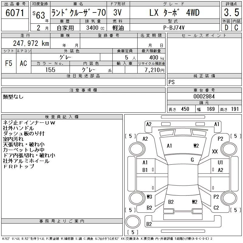

This vehicle was advertised as having "91K" miles. Auction data from Japan shows it was sold with 247,972 KM. Odometer has been rolled back. Michael at Mendel's Garage is a repeat offender and is aware that he is selling misrepresented trucks. Michael at Mendel's Garage was informed of the discrepancy and did not update any sales material before selling to an unknown buyer.
