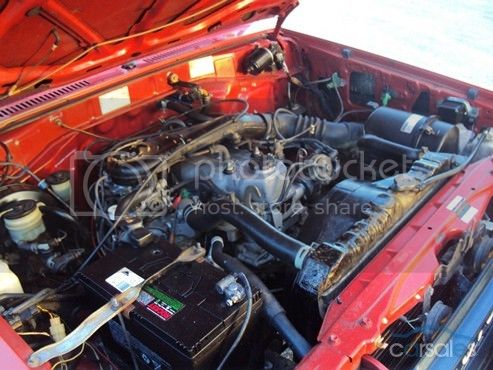

oh ok, mine has the 22r and the airbox is on the RHD passenger side.
exactly like this one i got from carsales
sadly i have never seen a snorkel for that side of the 70 series ...
