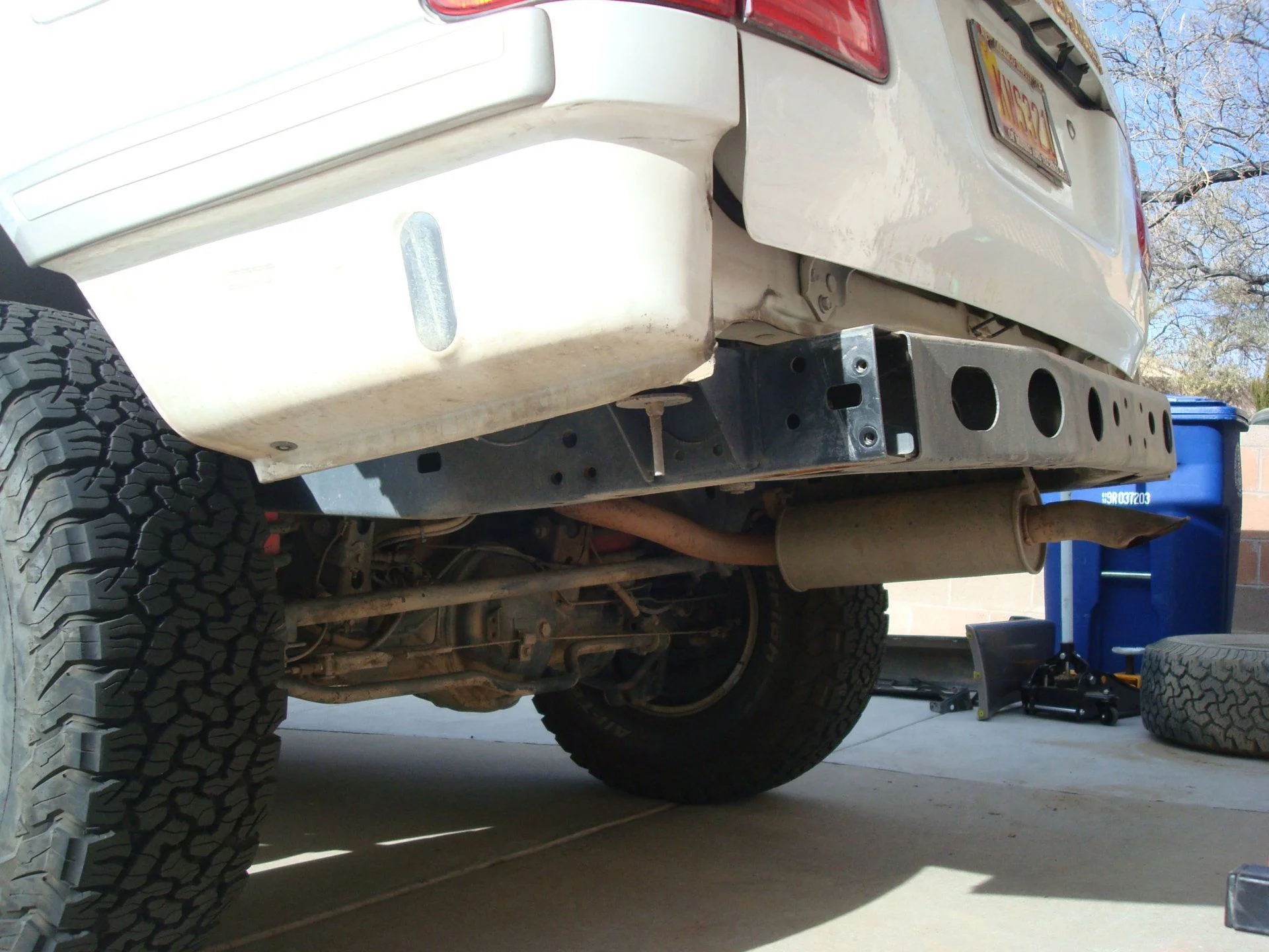

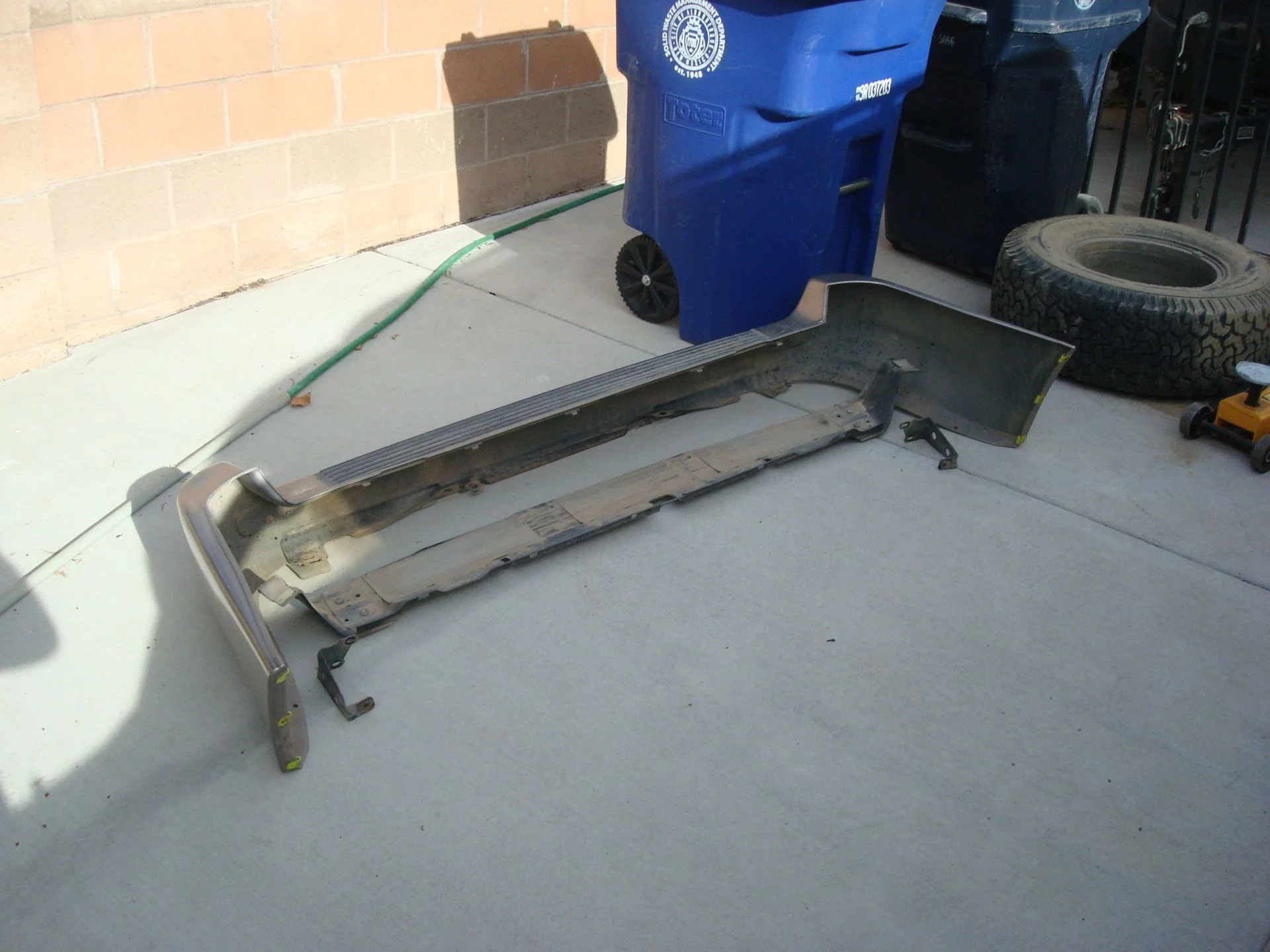

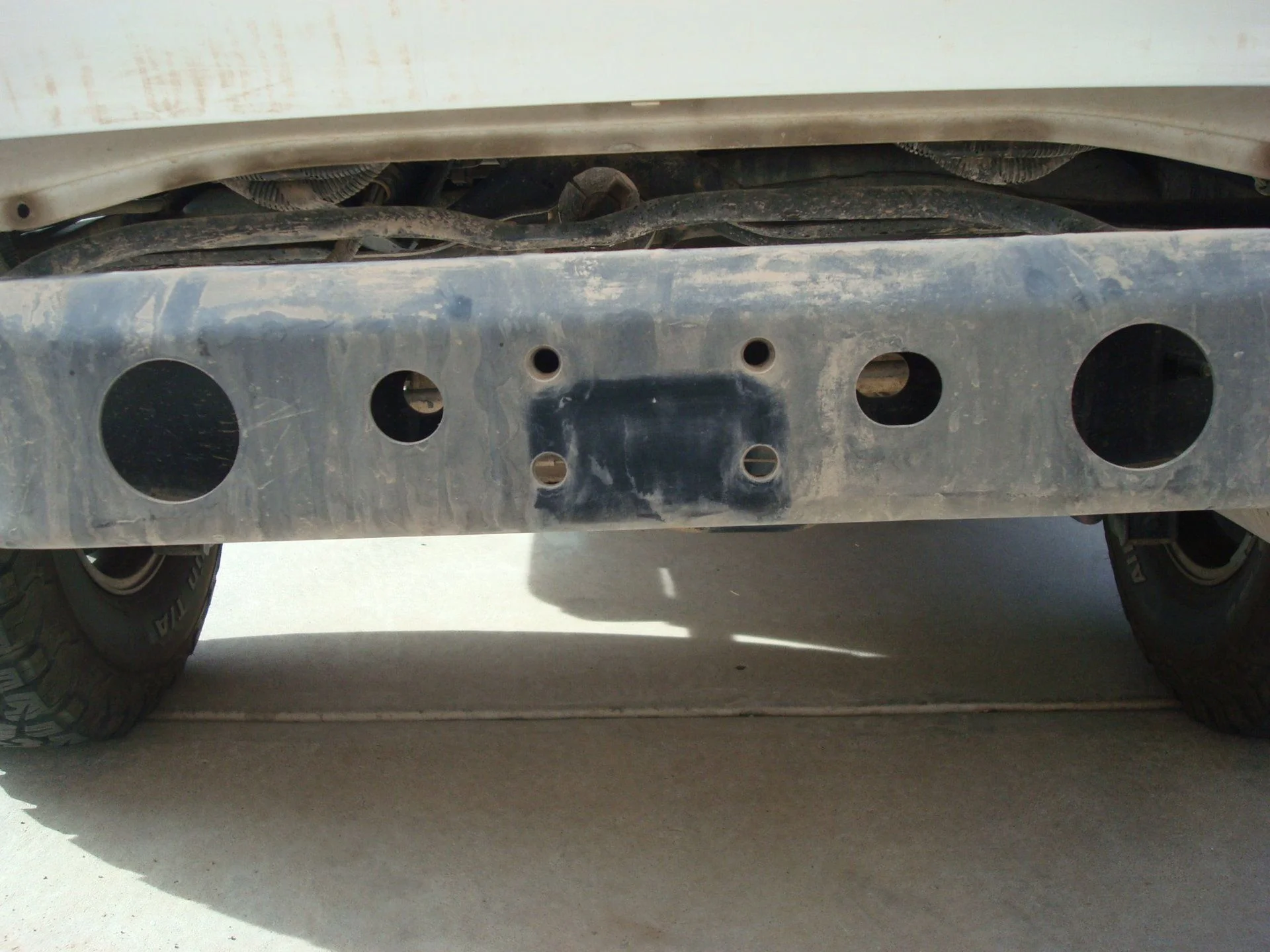

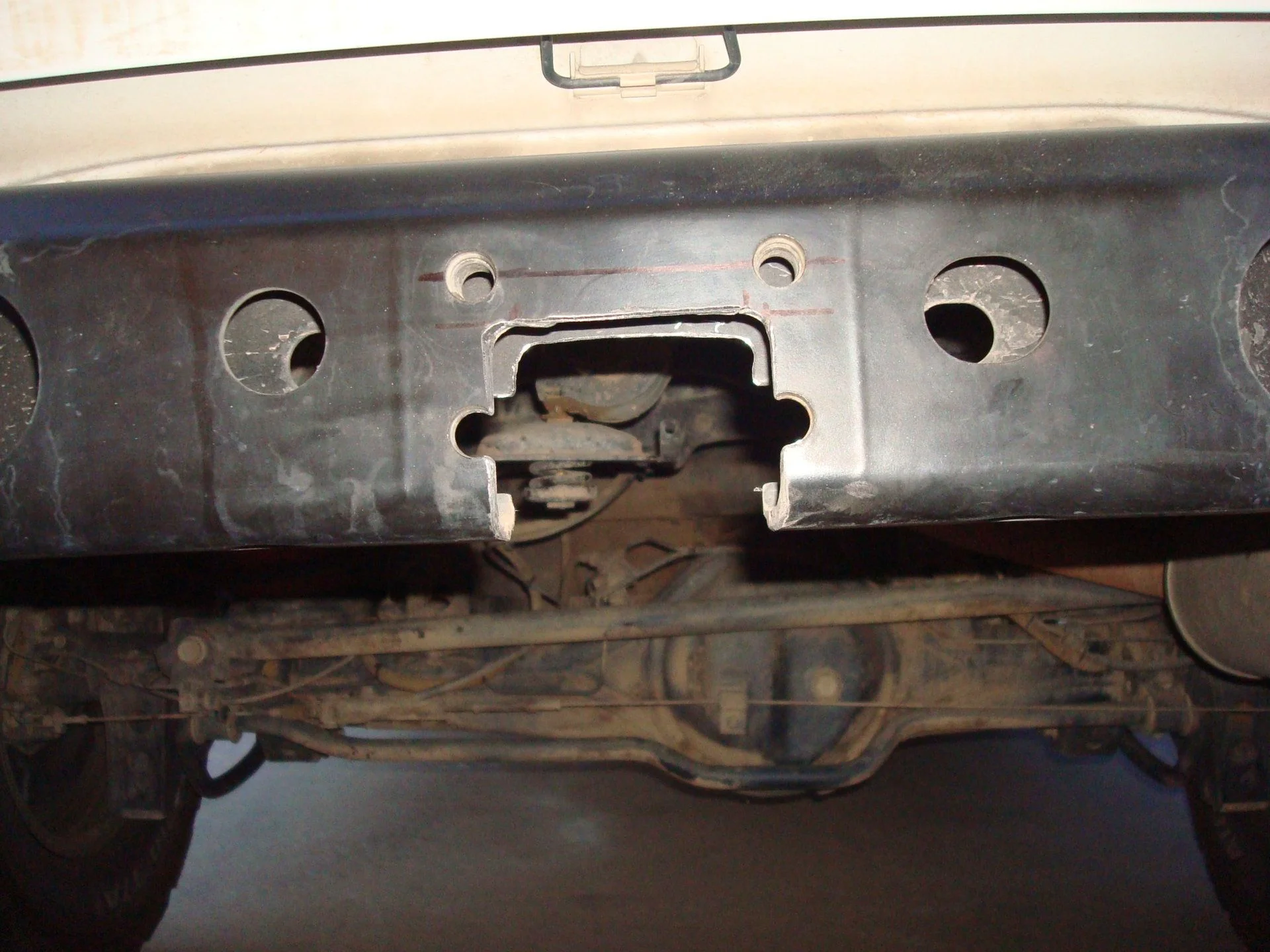

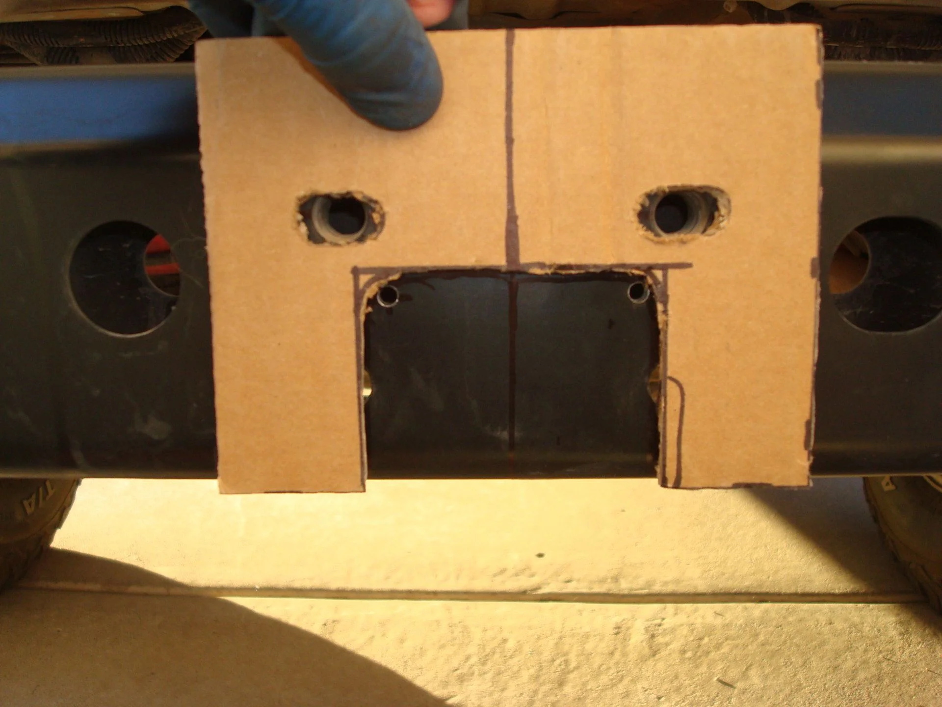

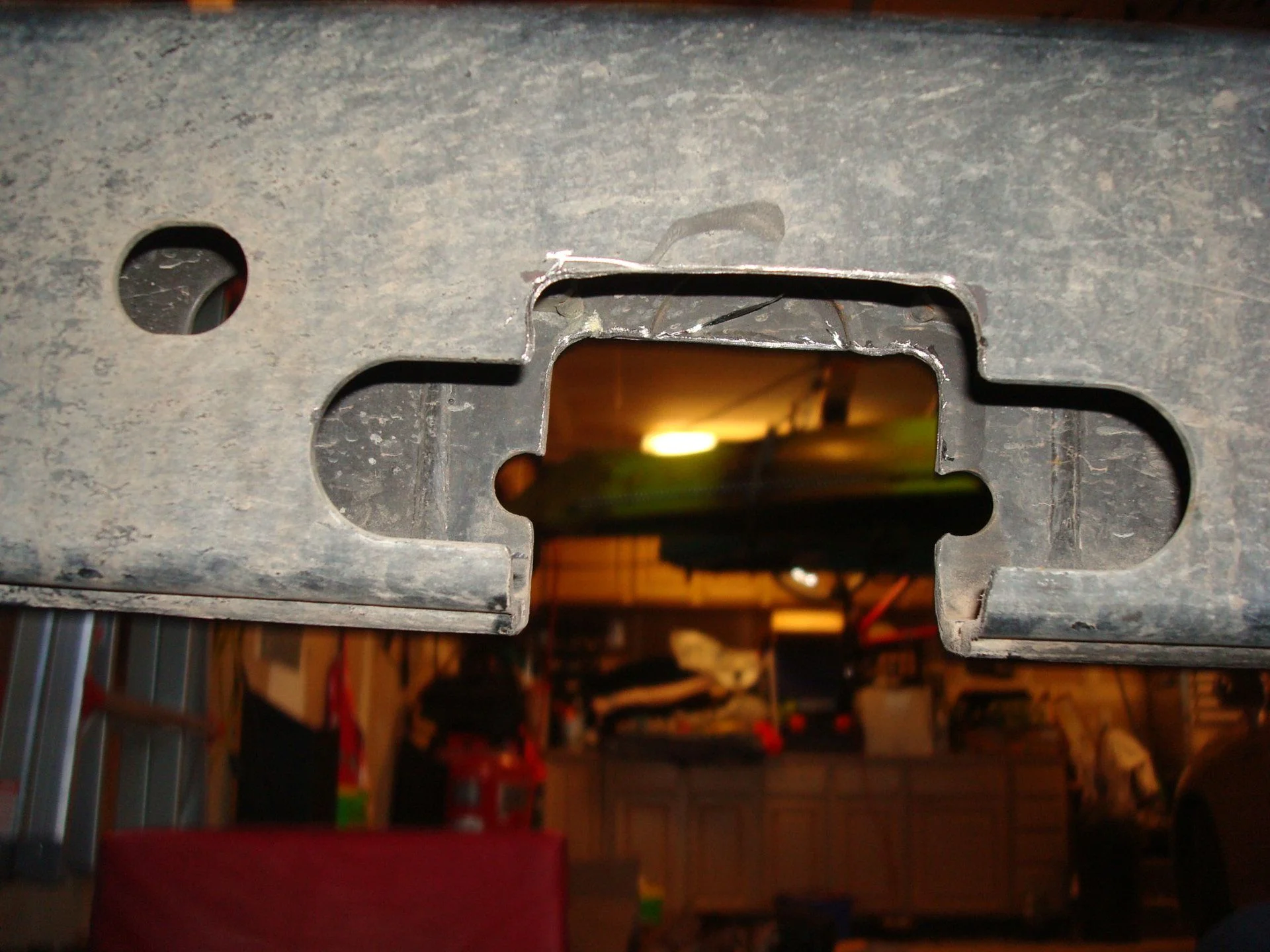

The only complication with getting the integrated receiver is that I have to cut a notch in the rear cross member. So I spent part of the day yesterday removing the old bumper, chasing the threads in the 14mm bolts that hold everything together and cutting the notch in the cross member. It was a little tough to work up the courage to cut my frame, since I've never done anything that crazy before.

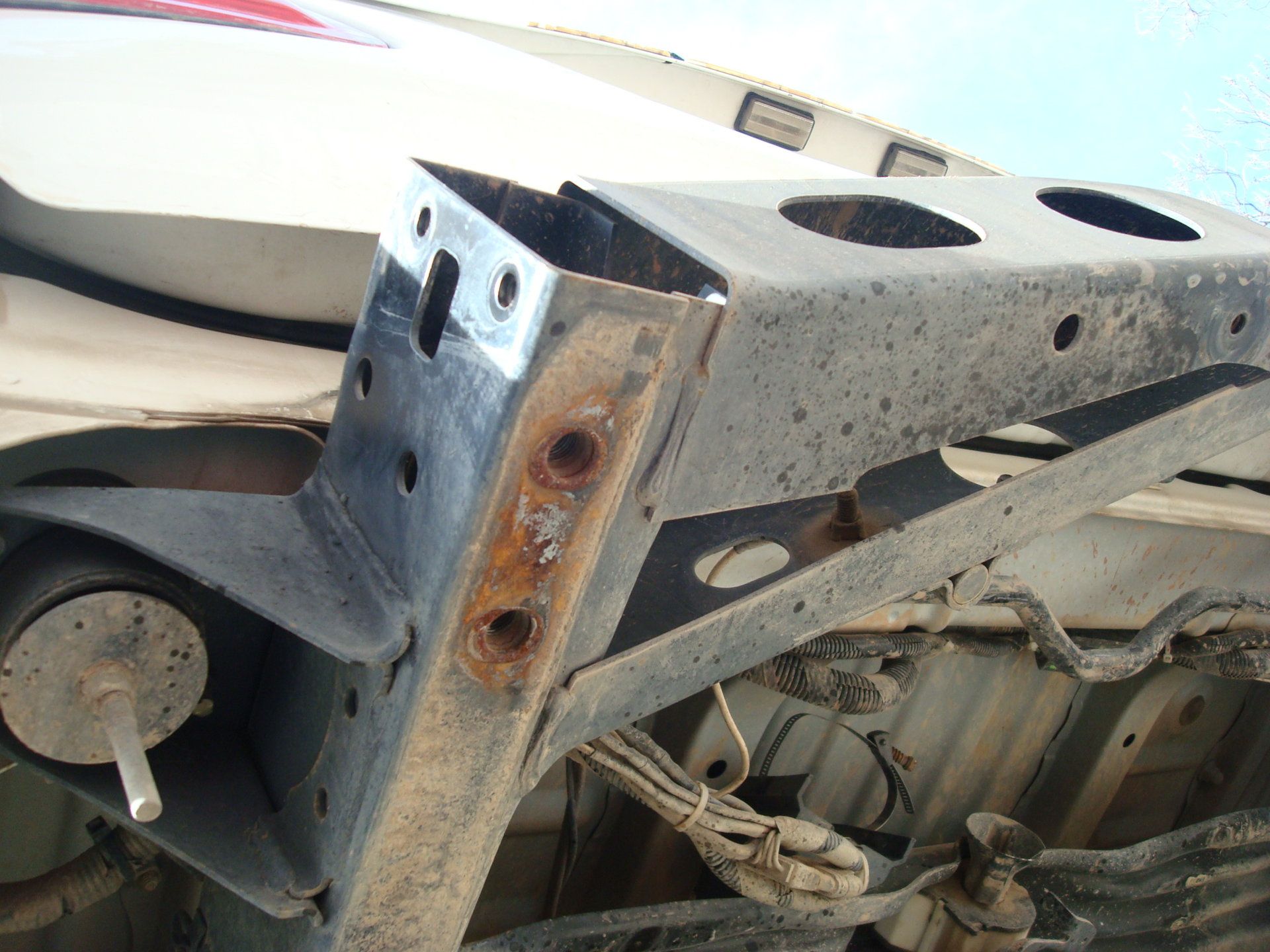

There was a little surface rust on the bottom of the frame rails where the old receiver was so I took a wire wheel and then a sanding pad on my grinder to clean them off. My next step will be to primer and paint the bare metal where I sanded as well as the bare metal around the notch for the receiver. Should have enough time after Christmas to get it wrapped up.

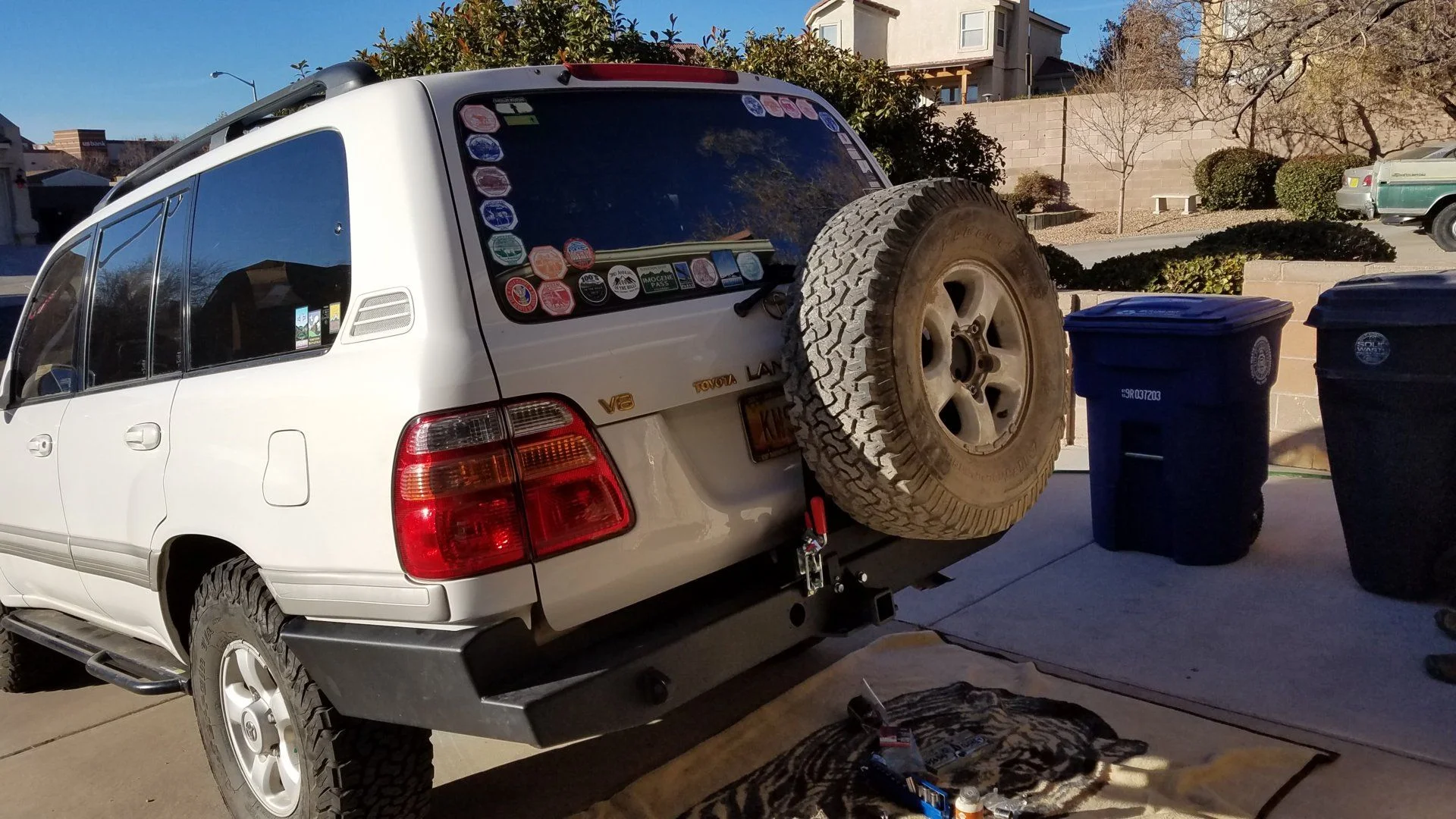

My plastic bumper had seen better days. There was lots of missing paint, broken/bent mounting features. I wanted a bumper that was more stout against scraping on things since she's a draggin' wagon. And while I'm at it, I should mount the spare tire in a location that it is less likely to be damaged during those dragging scenarios. Lastly, I tow stuff with my cruiser so I needed something with a stout, integrated receiver.
I will try to get some pictures today. Jon, Grant and Ron stopped by to help. Ron donated some parts off his hi lift mount to act as spacers where I needed some spacers/shims. It's really stout and looks good too.
Hey! Ash! Leave the fella alone! This bumper is just sexy.
Damn that's a sexy bumper!
Looks great! Much more trail worthy now...
