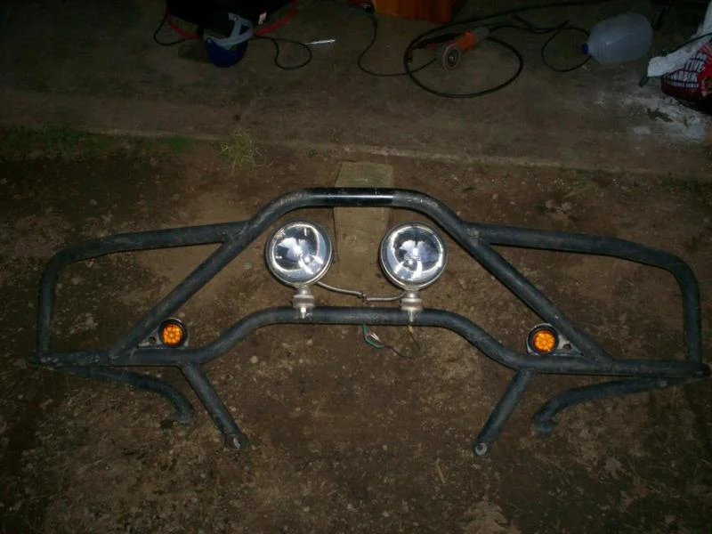

my mini has always has a receiver at both ends, but with the s***tybuilt bumper my cradle didnt fit. so i built my new bumper around the new winch and cradle.

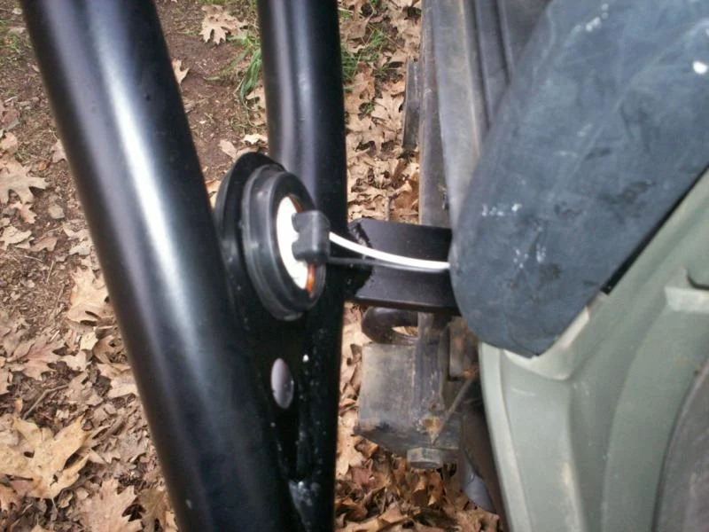

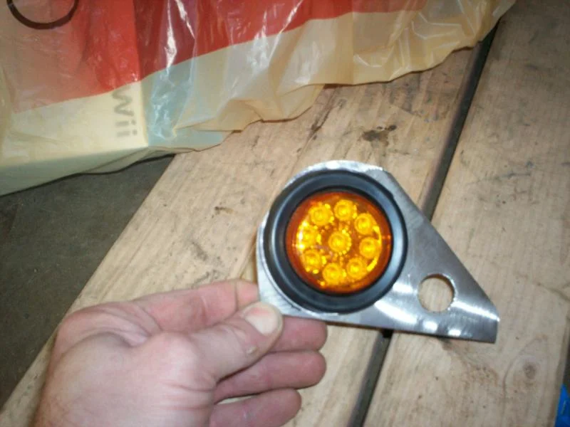

i never got around to putting my turns back onto the new bumper. i just said "forget about it" and decided on some LEDs for replacements. so i got a screamin deal through harbor freight on some 2" 9 diode amber lamps, they were 5$ per so i bought an extra in case one was DOA or for when one gets mashed on the trail.

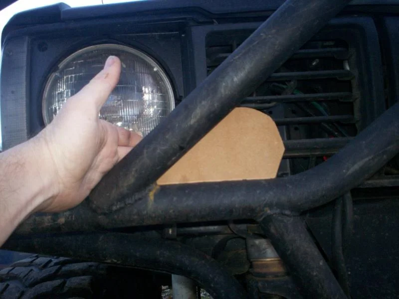

first pic is my cardboard template, make out of your favorite beverage box.

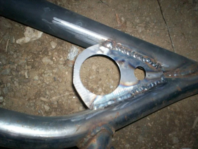

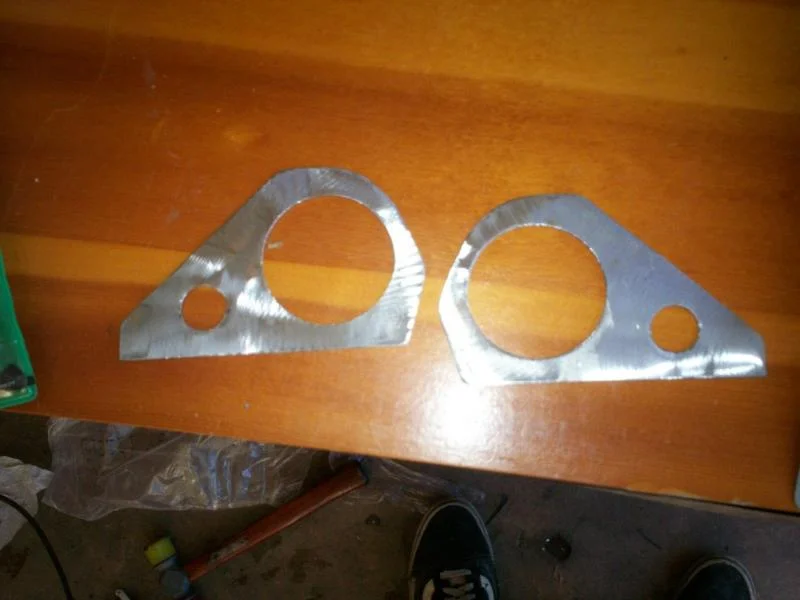

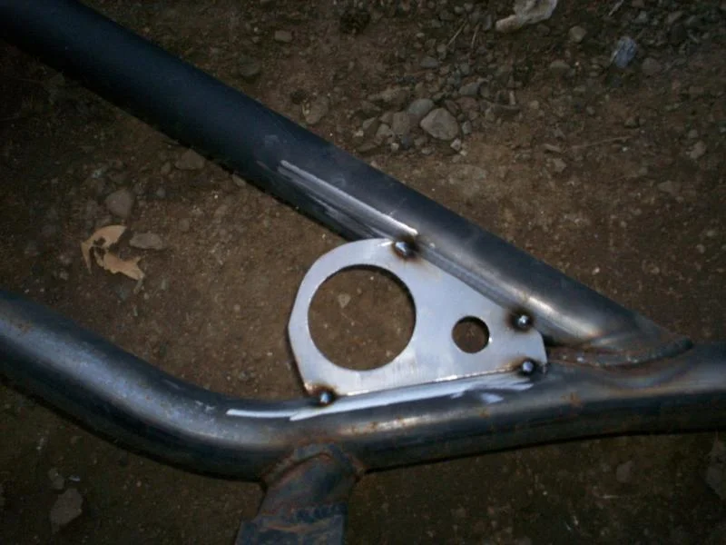

second is the rough parts

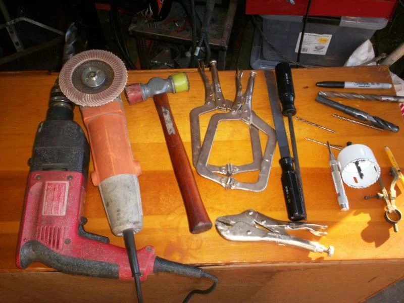

three is the pile o' tools required
