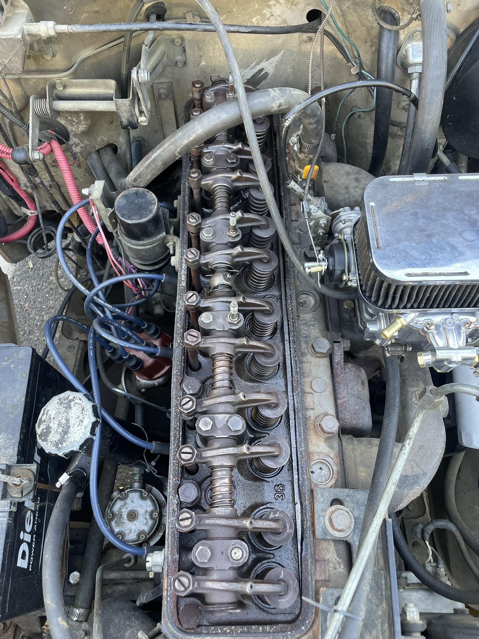

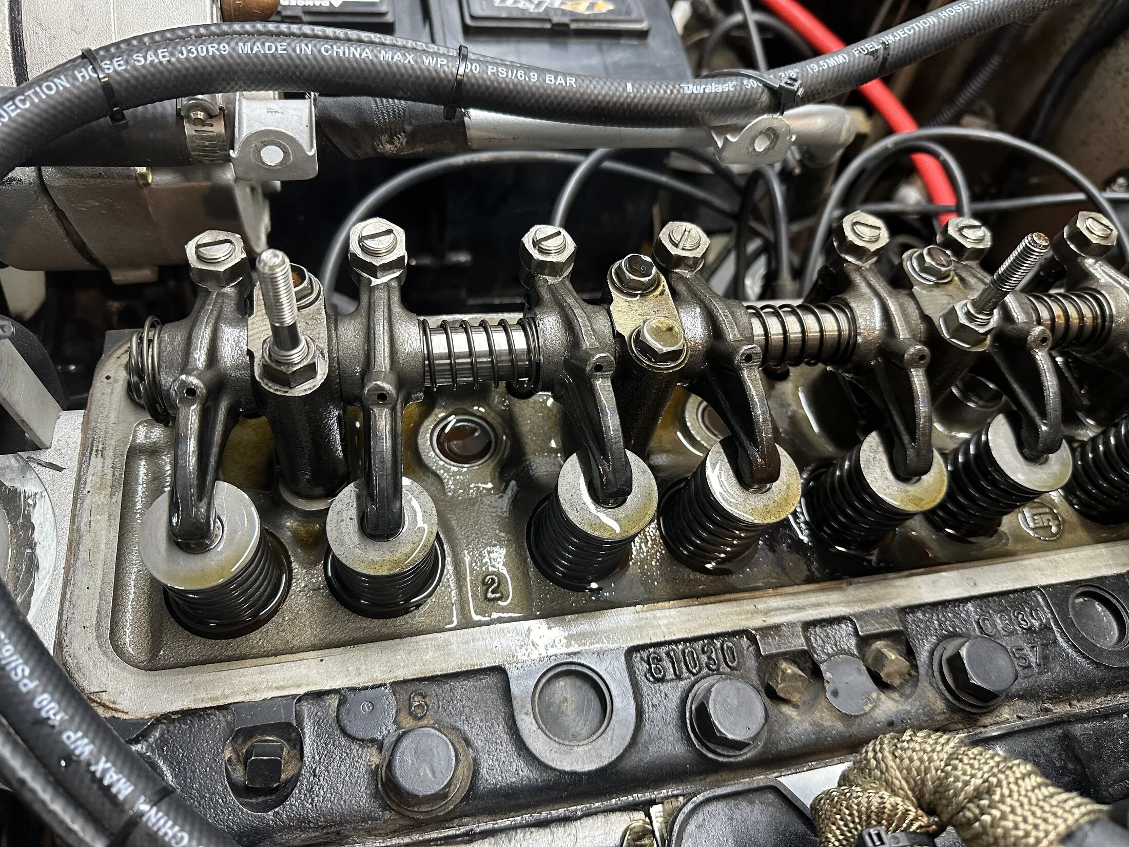

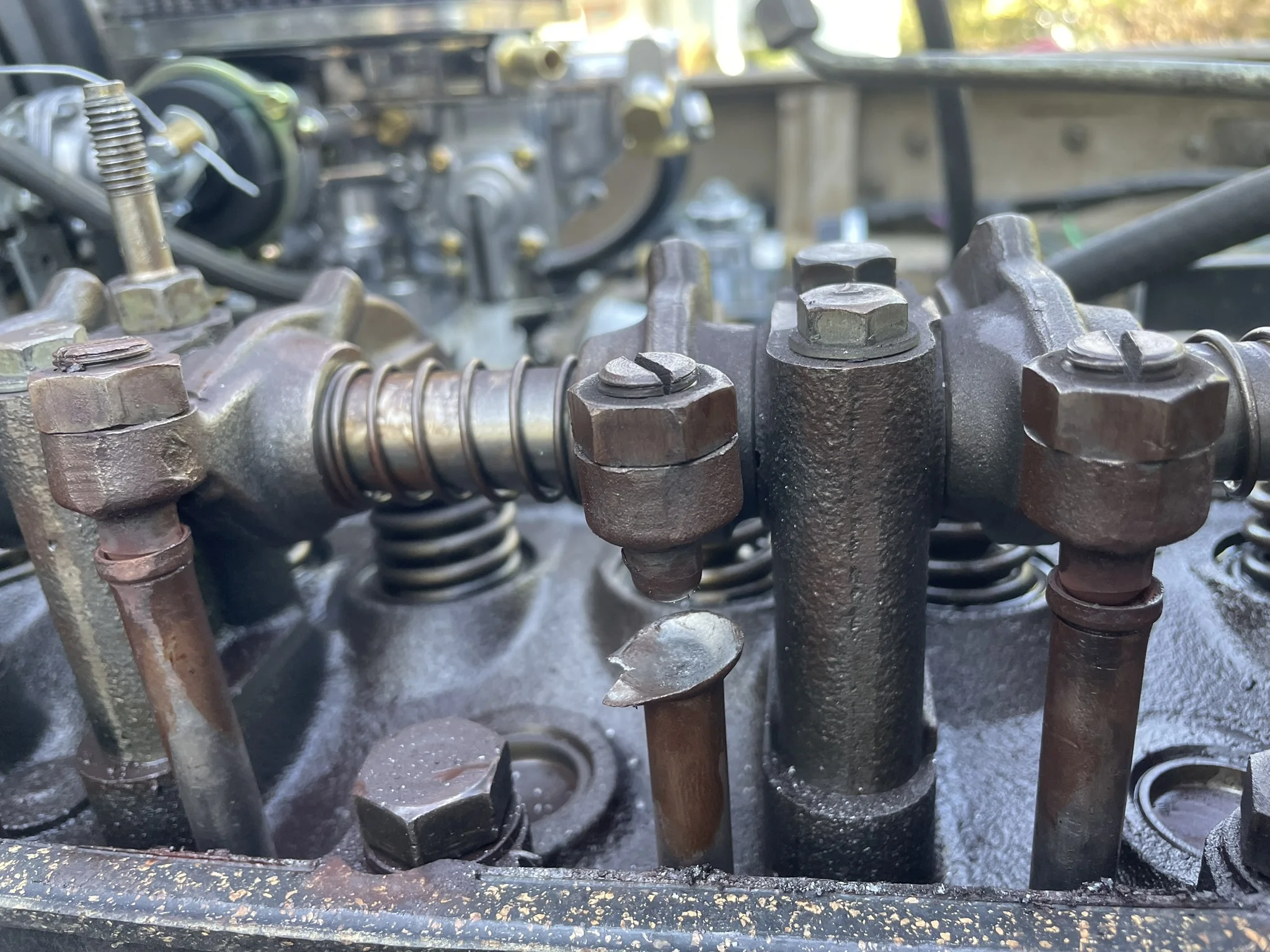

Good news!! There's quite a problem. I got the valve cover off and there's a lot not to like. The valve on the non-springy side of the cyl #2 exhaust rocker has been 'self-modified'. (see the photos). Also, I think there's an issue with oil getting up here because it seems much to dry.
When the engine runs, the cyl2 exhaust rocker doesn't rock (the rest still do!). Not hard to see why! This must be the root cause of the popping. Perhaps the oil is the root of why it broke in the first place.
The good news here is that I found something to fix! The bad news is that I have no idea how... yet! Has anyone modified the interaction between the rocker and the valve head before? I'd bet that's iffy territory, but I'd like to avoid opening the engine up if I can.
As for the oil, I'm going to do a change or two to see if that helps free things up.

Bad news: you’re going to have to “open up the engine” even if that only means replacing the rocker assemblies.
Good news: there are tons of people here to coach you through it. After 20 years on the forum, I am no longer a regular in tech, so it may not be me.
It does seem you are lacking oil. So you should plan on having to replace the entire rocker arm assembly. Just because the other parts aren’t frozen, doesn’t mean they’re not damaged from lack of lubrication.
Based on my experience, I’d say there is also a fair chance that the lack of oil is from a breach in the copper tube that feeds the rockers. You are going to have to take the side cover off the engine to inspect/ replace that.
