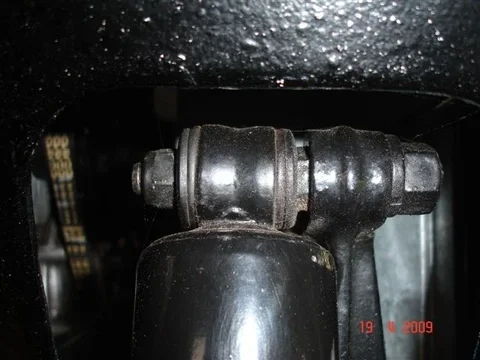

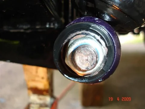

You can see that when I fit the bushes correctly (with the convex sides of the washers against the urethane) they tend to bulge/squish out before I can get the nuts snugged up completely.

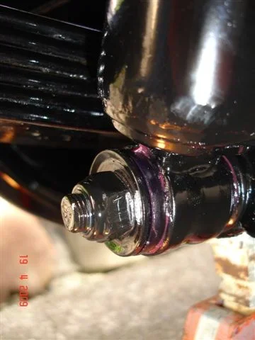

To solve the problem with my front suspension I turned the washers the wrong way around:

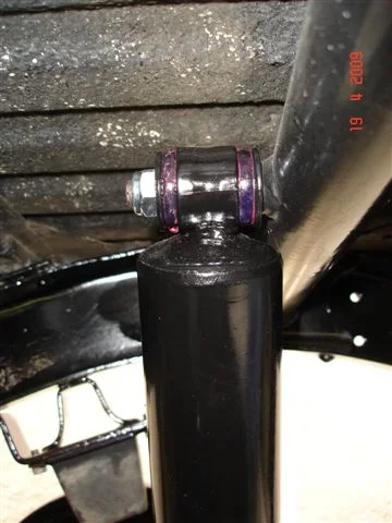

And to solve the problem with my rear suspension I left the washers the correct way around but simply didn't tighten the nuts fully:

I think I prefer what I've done with the rear because having the convex sides of the washers against the urethane provides less risk of the shock eyes touching the washers on "max suspension flex".
