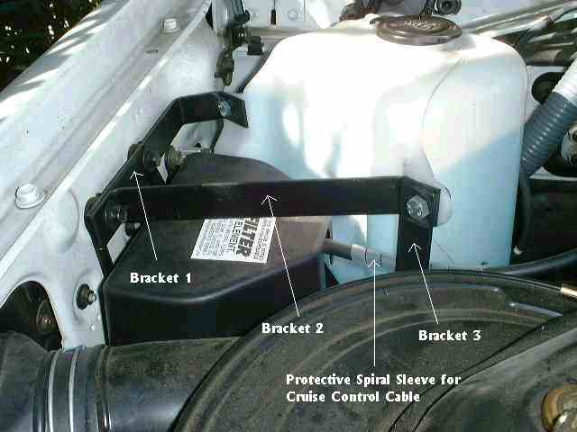

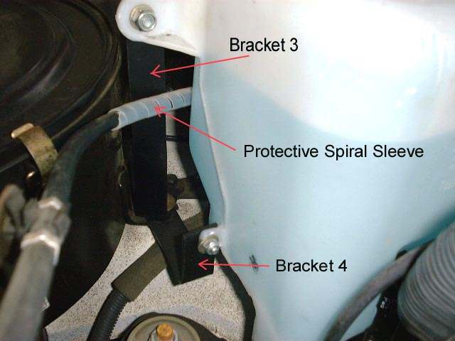

Mine, pre-scharger, 4 brackets 'formed' in a vise from 1" x 1/8" stock.
There's a 4th bracket below that the bottle 'sits' on that mounts to a lower stock bolt.
Stock bottle and easy access to the diagnostic port.
Many ways to skin the cat :)
cheers,
george.
Absolutely agree about many ways to skin the cat!
