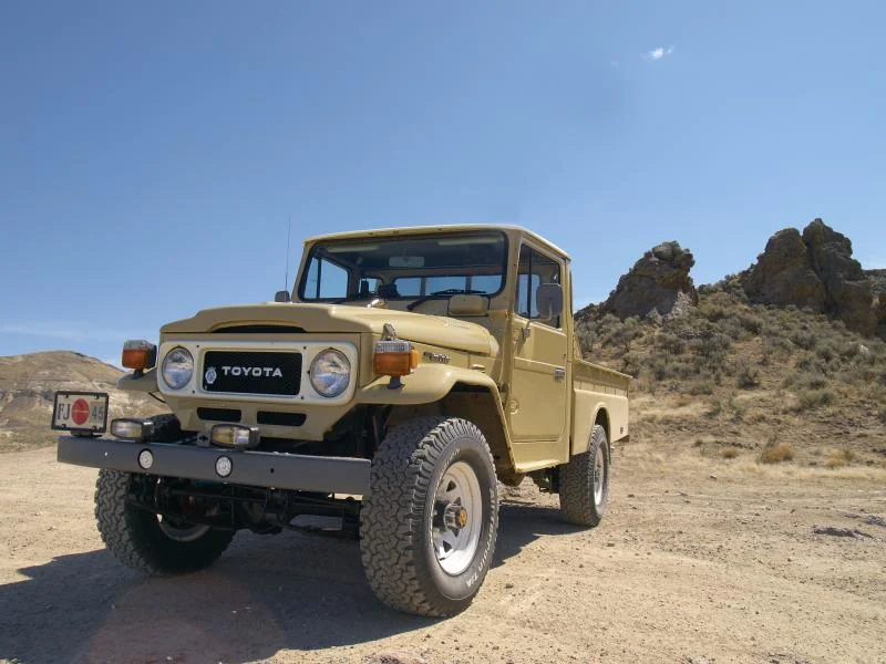

Have a question to any 45 owner in regards to high speed driving (50-60 mph and up) on a paved road. Question is when driving with a slight head or cross wind do you guys or girls experience a slight to moderate bit of buffeting (shaking) in the front end of the truck. I have owned lots of 40's and this is my first 45 and never really experienced this with a 40. At first I was thinking it was wheel problem as in wobble or tie rod. I can only think it is the front wheel fenders sucking air up under them trying to get the front end airborne, or maybe the old thought that the air is slamming into the old flat windshield and then vortex's into the LWB in back pushing into the tail gate. It's a little unnerving at times.

I agree Gumby that it can be almost anything, to possibly help with that, I will include some of what you have offered as a possible suspect with an answer:
Center pivot- New and adjusted twice after a few miles for setting in
TREs- All new
RREs - ?
correct shims on the knuckles - set with the official Toyota tool - good
Toe properly set - set to factory specs
Aftermarket springs causing caster issues- re arced to near standard high, not jacked up.
Hard, worn out, or tight spring bushings - new pollys, all allow movement without being over tight.
shackle extensions- stock
old, worn or over sized tires- new tires
out of balance tires- balanced
broken belt in a tire - 10 ply ?
u-joints - all removed on build and inspected (good) installed
out of balance or bent drive shaft- D/S tube replaced with new
transfer case output shaft -will check
pinion bearing - will check
wheel bearing- new and set
trunnion bearing - new
New shocks F-R
All front end items are all tight, and torqued to Factory I/A/W manual
Has new disc brakes installed from FJ62 that show no abnormal scoring or wearing
Tire wear looks normal
Hubs locked? not locked, rolls free, and locked when locked
Good stuff to check will see about the one's you mentioned that have not been checked or replaced.
Big Thanks

Thanks again for the help, the tires had be balanced just last month with no discrepancies from the tire person. The springs being reworked and the tires maybe the combination that possibly may be causing this condition.If so it maybe just a break in time for both items to settle as they are new. I am still going to look at a few other areas as mentioned, and again at the steering box 65swb45. I had set this while the cab was off and again after rebuild completion, but one never knows. Oh yeah I forgot to add that the front steering stabilizer was also checked and is working fine, not sure if I need to go to a HD type due to the tires.

Took the old gal on the freeway tonight on a 5 miles drive to the store with the tailgate down, full load of fuel, and pushed it to 65 mph without any buffeting at all, but it is also calm of winds tonight. On the way back with tail gate up, and 65 mph still no buffeting. So that tells me that this most likely is a high wind related problem 10 mph up. Its funny when it happens it feels like the truck is wobbling like you would feel during an earthquake (if you have ever experienced that its weird). I am looking into the steering stab to see its condition. Will pull it off tomorrow and retest it. As noted by a Mudd member not all rigs are the same some may have its own little quark. I am still leaning towards the wind getting up under the front fenders and causing havoc. Give me a few more days, and one with wind, and I should have a conclusion, I hope
