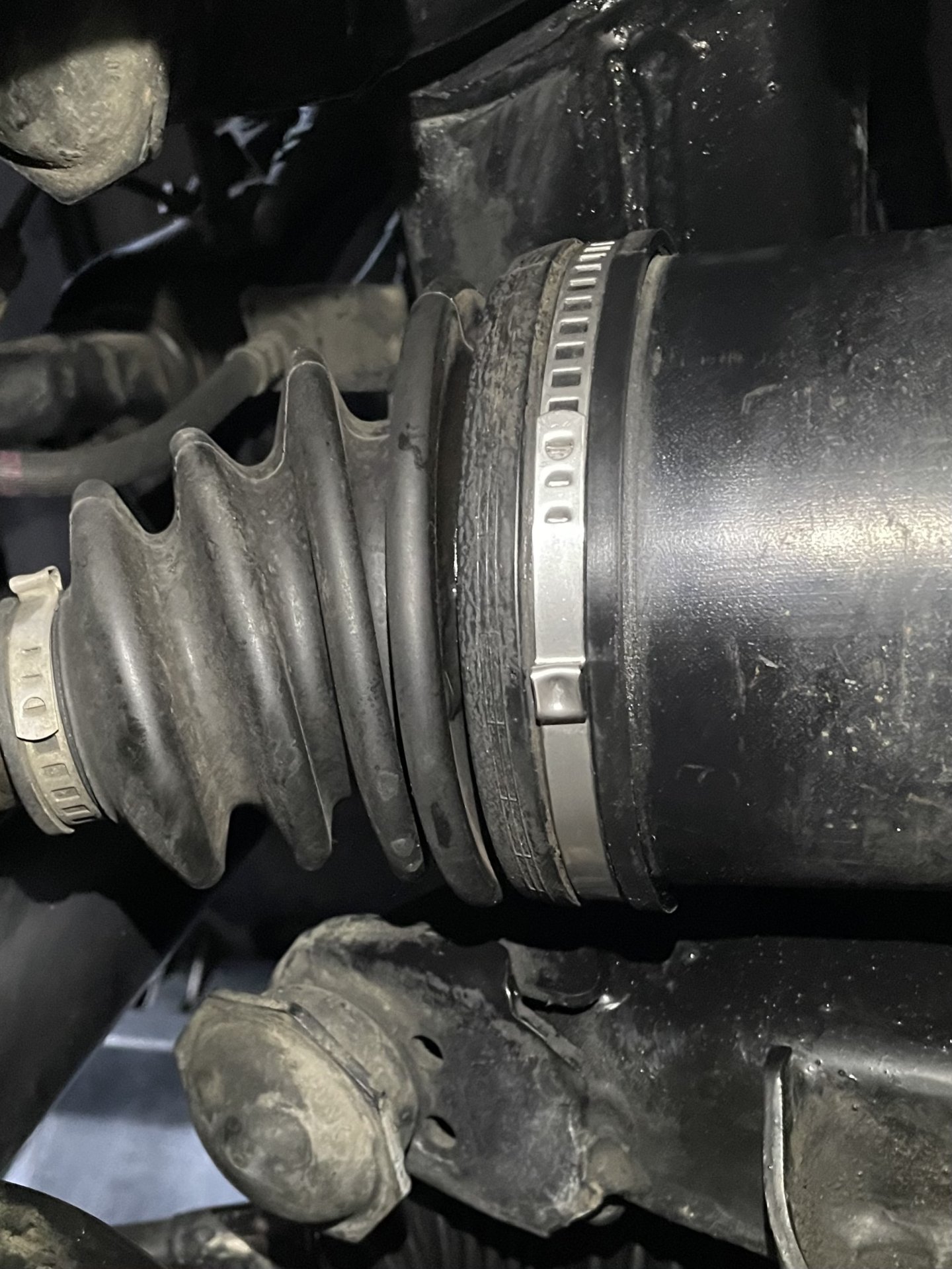

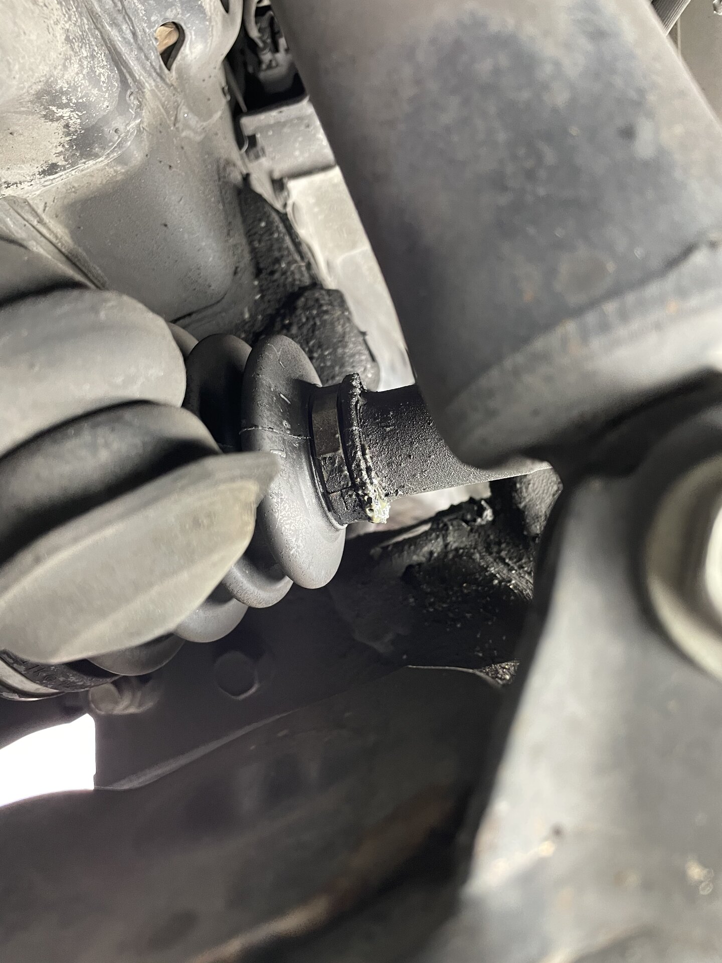

Noticed my driver side clamp (driveshaft on the wheel side) is broken during my yearly oil change. No grease has leaked out. Is this fix as easy as getting a new metal clamp and installing it?

I don’t know if you just stated it wrong or what. That loose clamp looks like it is off the diff side tripod boot.
I may have! Assuming the bottom of the picture is the wheel side, the red circle is the clamp in question. Thanks!
Like fjc-man suggested, the area you have circled in red has the yellow clamp in place, per the pic in your first post. The loose clamp is from the inboard boot.

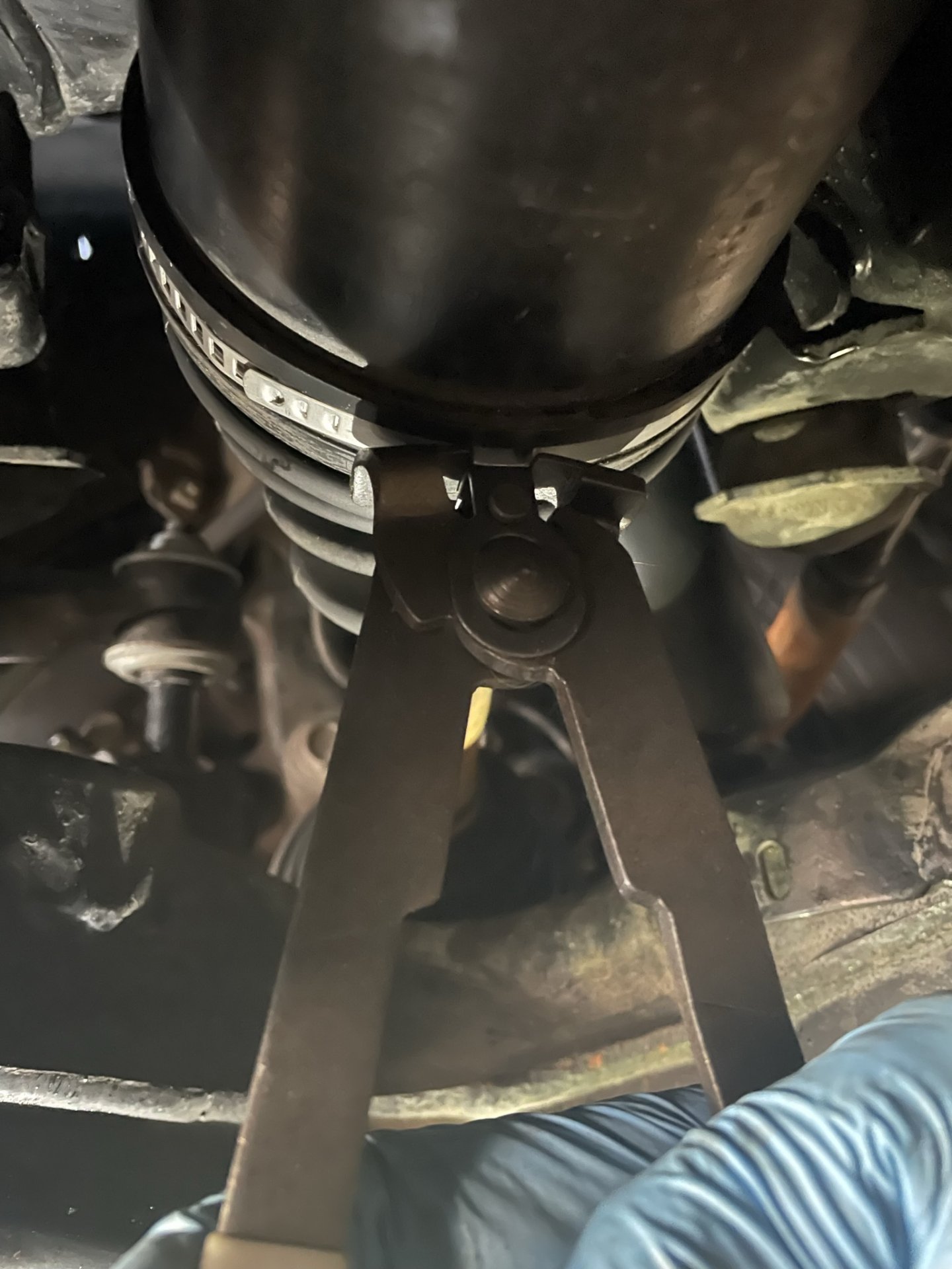

Ordered the clamps from Napa. It was less than $3 per clamp. Worked out great. Bought the clamper tool on Amazon. Super easy. Probably took me 15 mins for two clamps (one side each). Just need to cut the old one off. The tool is self explanatory when you use it.

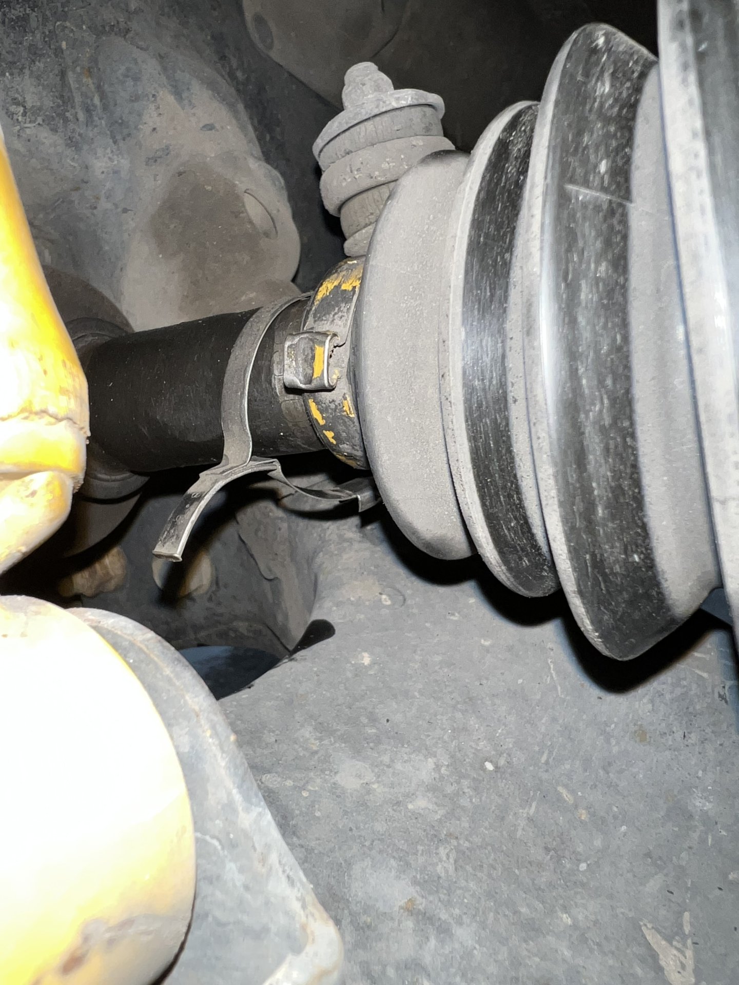

Before I changed it.
