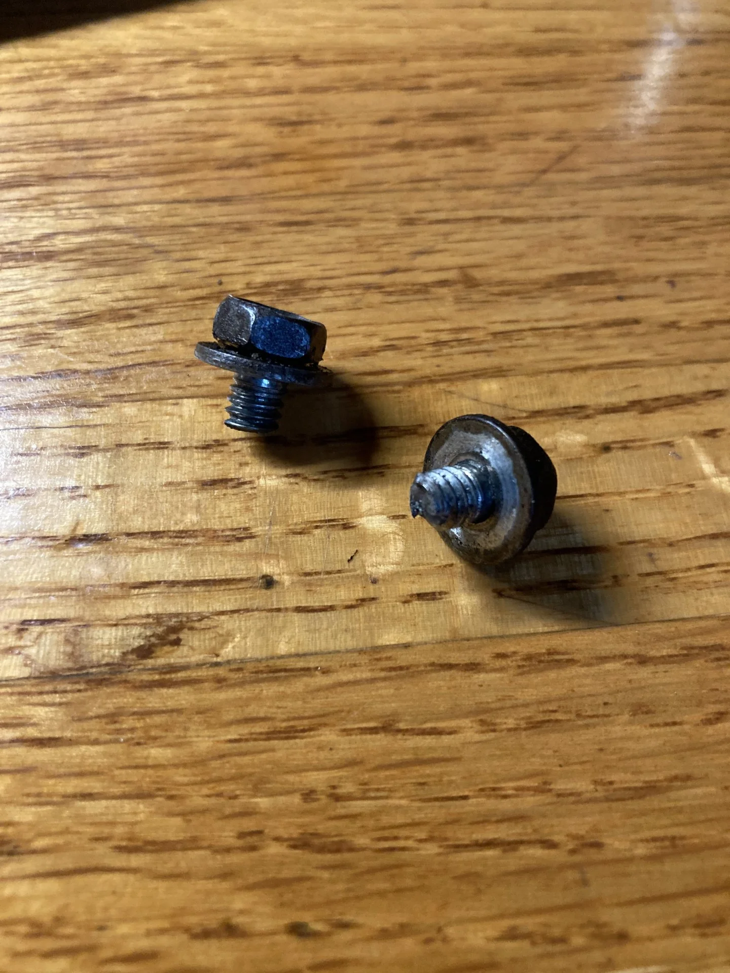

Nice surprise taking the bolts out of my hub cover- two broken bolts that had been “glued” back in.. ideas or tricks on getting the rest of the bolts out of the hub body?
