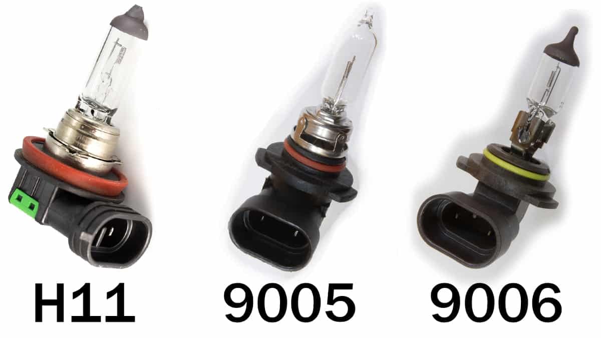

So for US spec 80 series the original bulbs were 9005(High) and 9006 (Low).
The harness connector in the photo above also appears to be a non-OEM (not factory Toyota) adapter.
Not the expert on lighting but it appears someone has substituted one of your stock bulbs with H11 bulbs?? The harness connector in the photo above also appears to be a non-OEM (not factory Toyota) adapter.

They are definitely h1 not h11. I bought replacement 9005 and 9006 but the 9005 hi beam did not fit in the headlight the h1 seems to be the right side but there is a adapter on end of the harness.

Neither did the 9006 I had to buy a 9003 to fit they are held in by a metal clip not a push and turn system.
