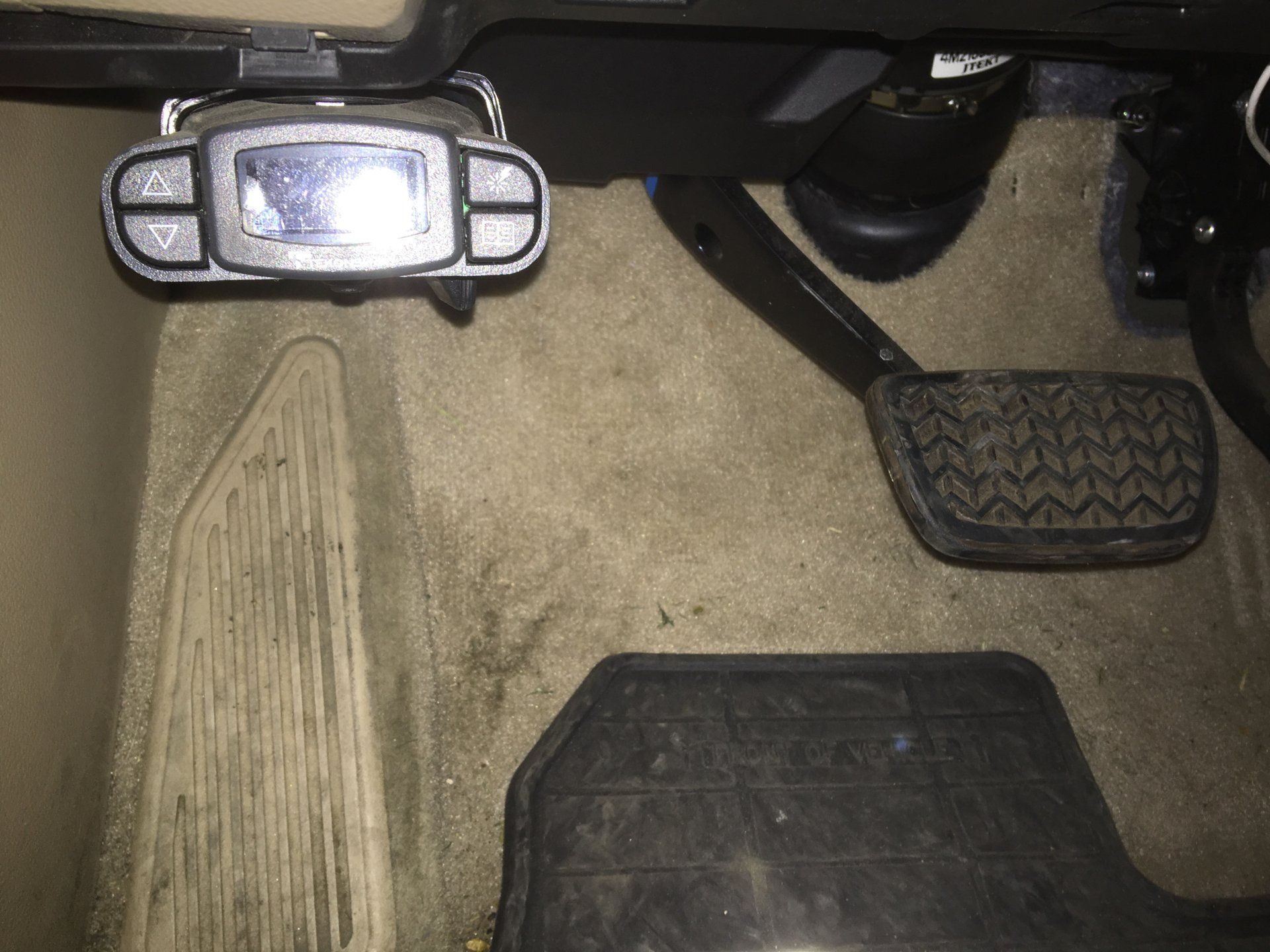

I did that Tekonsha. It was pretty easy to install aside from the screws for the mounting bracket. I put it about where you’d have a foot parking brake but closer to the brake pedal. There was room to tuck the wires up into the paneling. It isn’t the most convenient for adjusting settings but it is out of the way. Here’s what it looked like after install

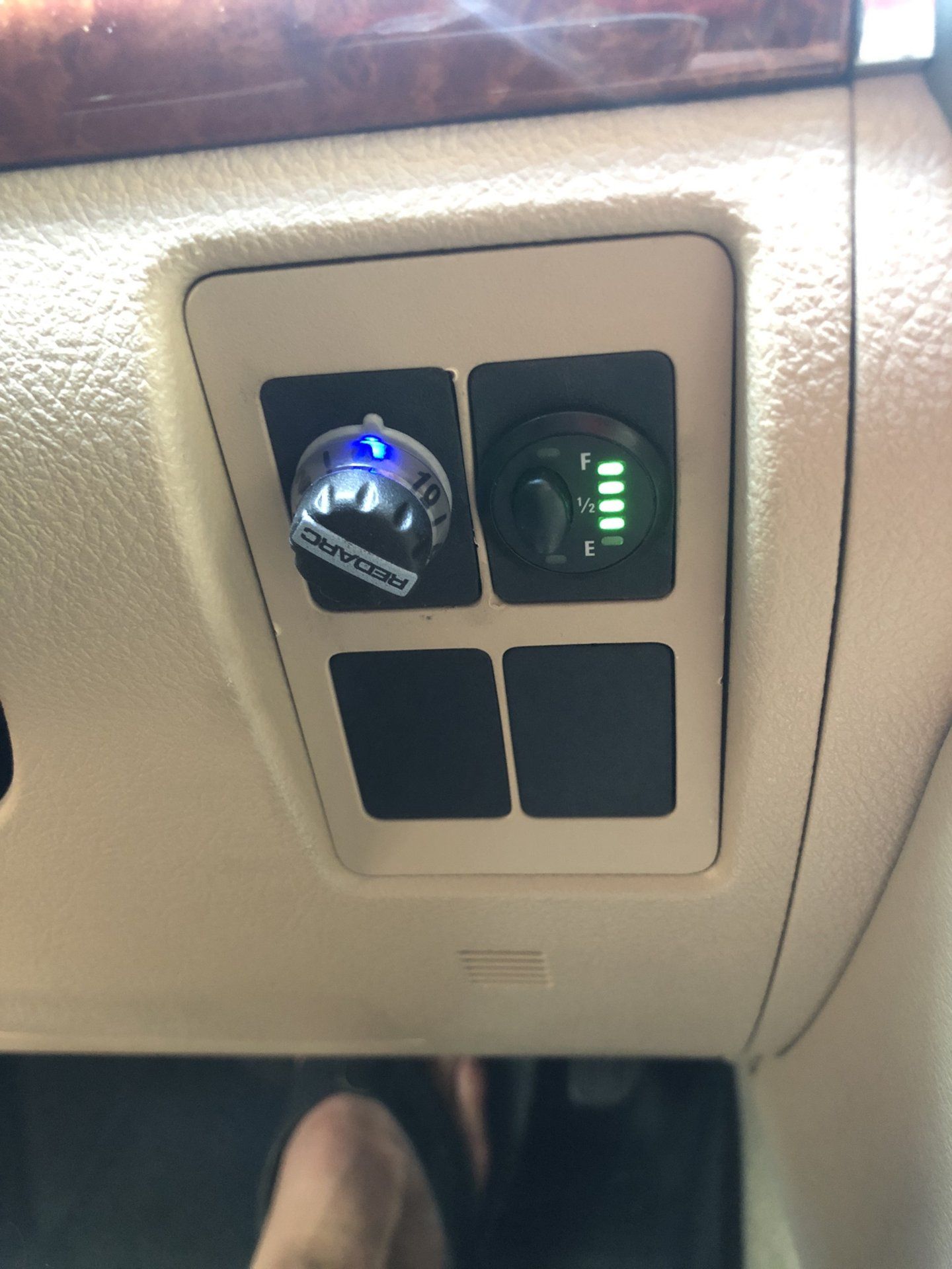

Redarc Towpro Elite. Fantastic controller and love the integration into the dash. Ive had the P3 before and it did a fine job. I tow a lot and found that both work fine, just like the adjustability and the knob integrated into the dash much better. I always kicked the controller when i had it mounted down by the footwell. FYI, Redarc even makes a dash button insert for the knob into the 200 so it all looks factory.
No doubt the mounting options for the P3 (or any other controller other than the Redarc) are very limited and not so good. If you install under the steering wheel, make sure you don't install over the knee airbag!
I tow an airstream with our LC and use the P3. The P3 functions great and is easy to set, but I hate it always hitting my shin. If you're 6ft or above, do the Redarc and save yourself the hassle. Everything I've read about the Redarc (on the forum and off) indicates they're pretty equal in terms of performance. There are some nuances between them, but nothing significant in my opinion. I think a few people on the forum have now used both extensively. The links that @Sandroad posted above will be great resources for you, especially the last link. I think that's were you'll see a couple people talking about their experiences with both. I'm looking to switch to it sometime soon but have other places to spend my $ first.
Another vote for the Redarc Tow Pro Elite. Easy install with the Toyota blank adapter.
Super clean install and you don't hit your shins on it every time you get in and out of your seat.
