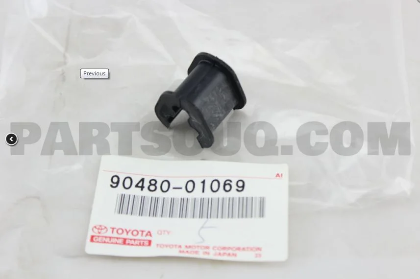

I'm no Toyota parts expert - but it looks like they've been superseded by a plasticey style?
Lifted from Tacoma World:
Would keep it all Toyota but obviously not correct and not as robust as original. I'll climb under the FJ Cruiser tonight if I think of it and take a look.

Do you need two or three line clamps? Thankfully @beno has a picture out there for the 3 line clamps.
47371-35020 is the grommet and clamp for 3 lines.
90461-08324 is the clamp for 90480-01069.
