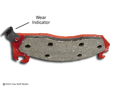

I don't believe there is a "squeak layer" usually the wear indicator is a piece of spring-like metal that scrapes on the rotor like a fingernail on a chalkboard.
From "How Stuff Works"
Brake squeal is caused by vibration between the brake pads, rotors and calipers. Pad noise can be lessened or eliminated by installing "noise suppression shims" (thin self-adhesive strips) on the backs of the pads, or applying "noise suppression compound" on the backs of the pads to dampen vibrations.
Conditions that can contribute to a disc brake noise problem include glazed or worn rotors, too rough a finish on resurfaced rotors, loose brake pads, missing pad insulators, shims, springs or antirattle clips, rusty or corroded caliper mounts, worn caliper mounts, and loose caliper mounting hardware.
