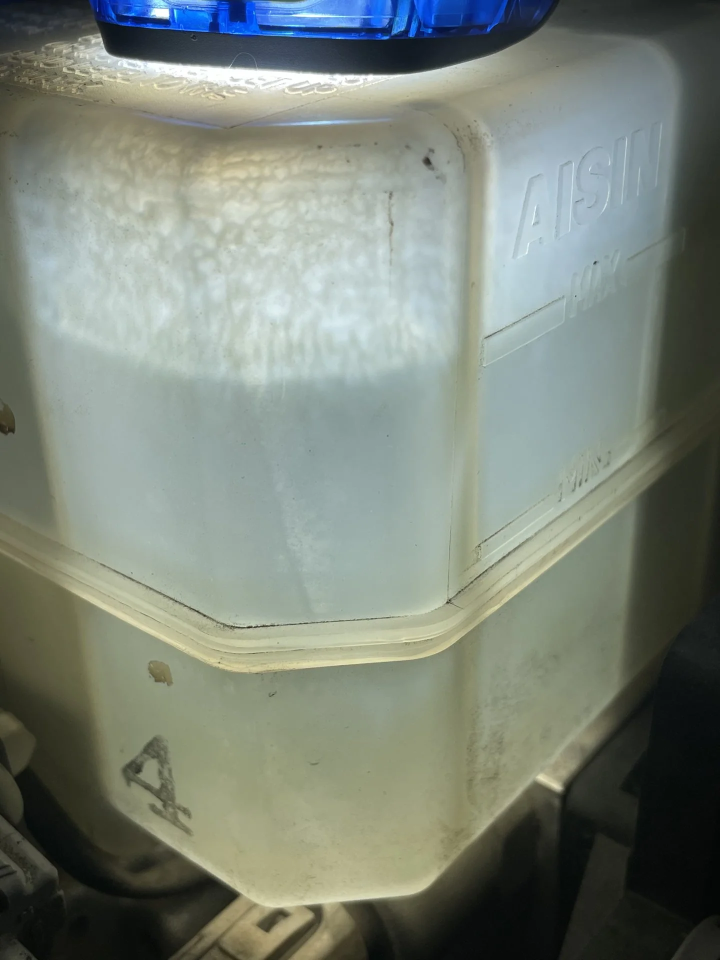

YES. This is a requirement, otherwise you’ll overfill the system and have a myriad of subsequent problems.Should I pump my brakes to return the fluid to the reservoir before emptying it and replacing with fresh fluid?
This doesn’t make any sense. The rest of the system (calipers and lines) will have old fluid in it. Flush the entire system with fresh fluid.I’m not interested in flushing the calipers but would like to get fresh fluid into the booster.
The fluid in the booster leaves the booster and goes to the lines and calipers. The booster is not closed from the rest of the system, otherwise you wouldn’t have any brakes.I’m more concerned with getting fresh fluid into the booster pump.My understanding is that if you pump the brakes(engine off) until the pedal goes to the floor,the fluid stored in the booster is returned to the reservoir.It seems that this would make the fluid change more thorough whether flushing calipers or not.
Does this work for the front wheels too?Brake bleeding on these systems are easy. Crack open the bleeder valve (attach a hose to drain), ignition on and paddle pressed.... let the motor to force out fluid through the hose..(IMPORTANT: Check the fluid level often. Don't let it pull air in)
I am not in my right mind now... it's Saturday night... but I remember so. Give it a try.

The condition of the fluid will be at its worst at the end of the lines to the calipers. Flushing reservoir with out flushing lines and calipers is almost pointless.I’m more concerned with getting fresh fluid into the booster pump.My understanding is that if you pump the brakes(engine off) until the pedal goes to the floor,the fluid stored in the booster is returned to the reservoir.It seems that this would make the fluid change more thorough whether flushing calipers or not.

Nah...I'm pretty sure there is an ABS aspect to this to fully flush the system that requires computers. I watched a YouTube video. A YouTube video!I flushed the brakes twice in past 5 years and was nothing more than flushing an ordinary vehicle with the exception of keeping the ignition on. I think front just press.. press and hold and repeat, while the rear just press and hold until fluid gets clear
Except the bleed sequence in the FSM is fronts before the rear... versus traditional method of furthest brake caliper first.I flushed the brakes twice in past 5 years and was nothing more than flushing an ordinary vehicle with the exception of keeping the ignition on. I think front just press.. press and hold and repeat, while the rear just press and hold until fluid gets clear
