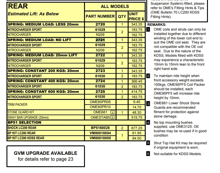

2721 coils are ARBs "medium duty" coils I bet they are rated for 2-400lbs constant load. I assume you bought this coil to get the ride height you want? If you will be unloaded in the rear consider a progressive rate coil rated for 1-XXX lbs to maintain a good ride quality.

the 2721s are progressive rate springs ((270/350 lbf/in). I've got my shocks set in the middle and have never played with the settings. The ride is comfy, maybe a little floaty. I don't really notice much difference in ride empty or loaded though my empty is still carrying 200 lbs of stuff.

Never knew ARB made progressive rate coils, their parts catalog never noted that - but that is neat. But regardless it looks like the recommended payload still shows 200lbs.
where are you seeing the 200 lbs recommendation?
I cannot find the article anymore, but when I was researching items for the Montero platform, spring ratings for medium duty (Front or rear) was rated around 200lbs vs stock/light load coils rated for an extra 110lbs upfront. and heavy duty coils around 350-440lbs. Not including any of there constant rate coils.
