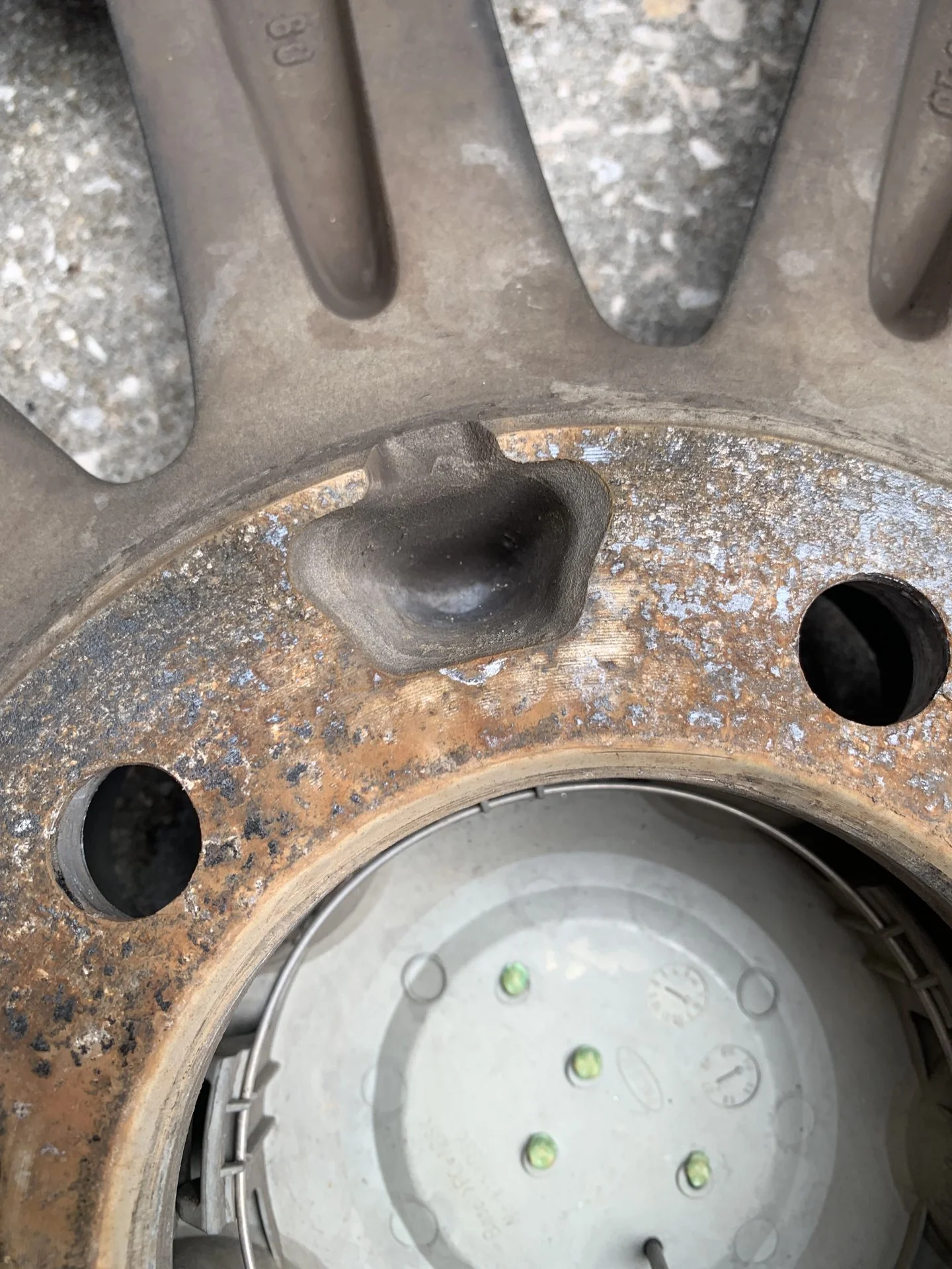

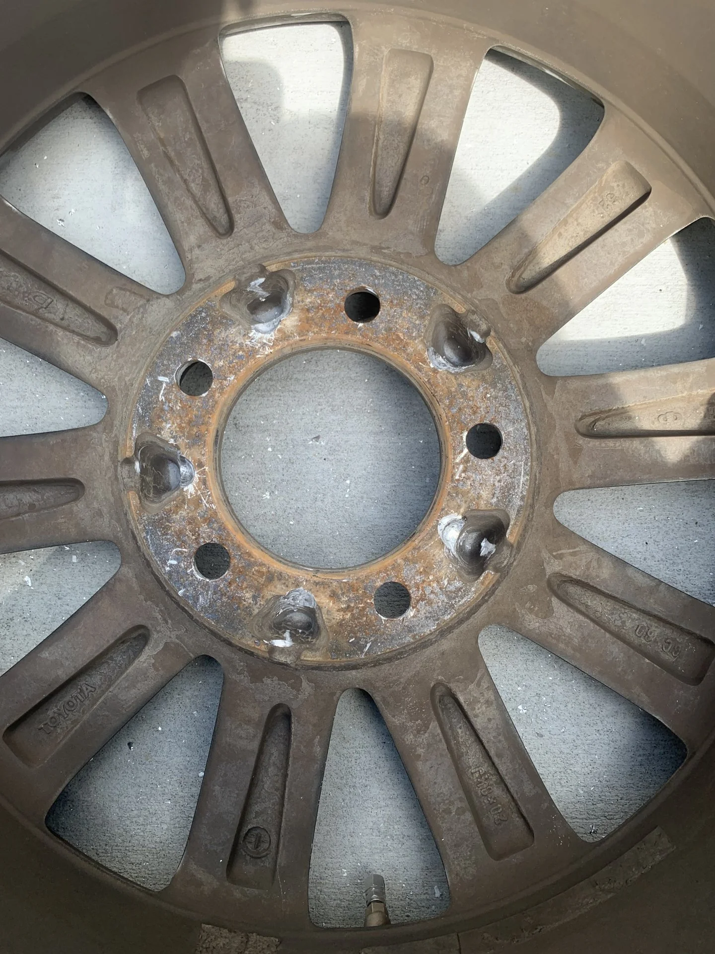

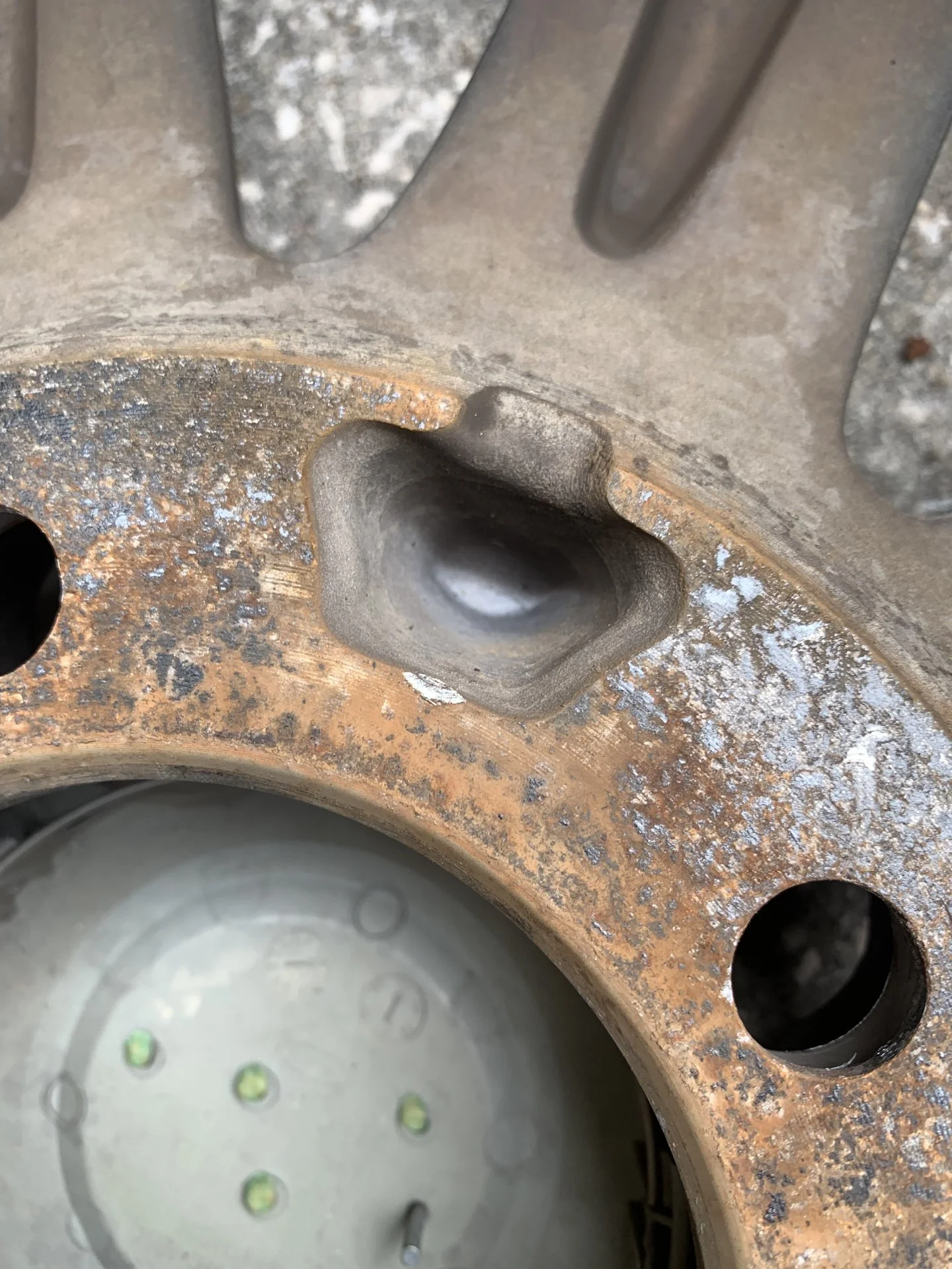

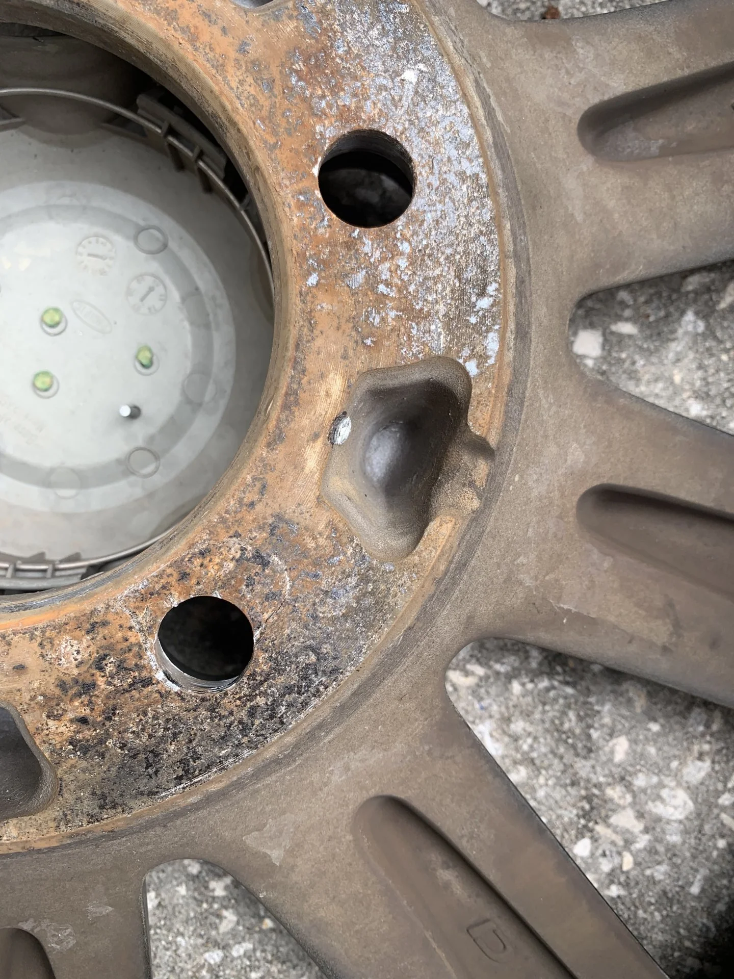

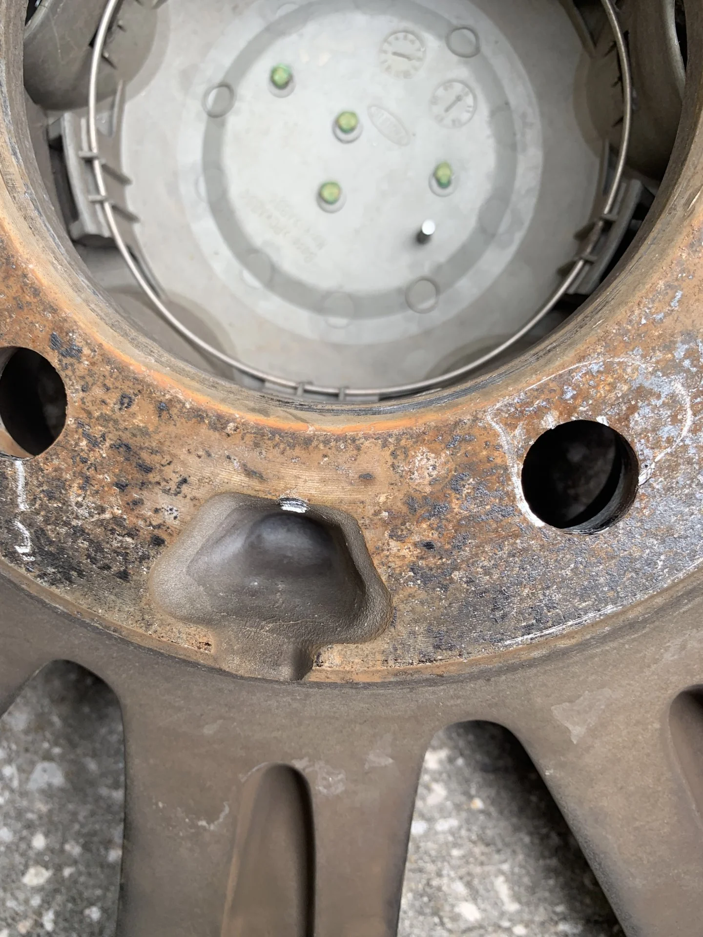

While the 08-11 turbine wheels have a space that seems like it would readily fit the original studs protruding…they do not.
You will need to remove material to make your 08-11 Lexus turbine wheels fit 0.75” spacers
