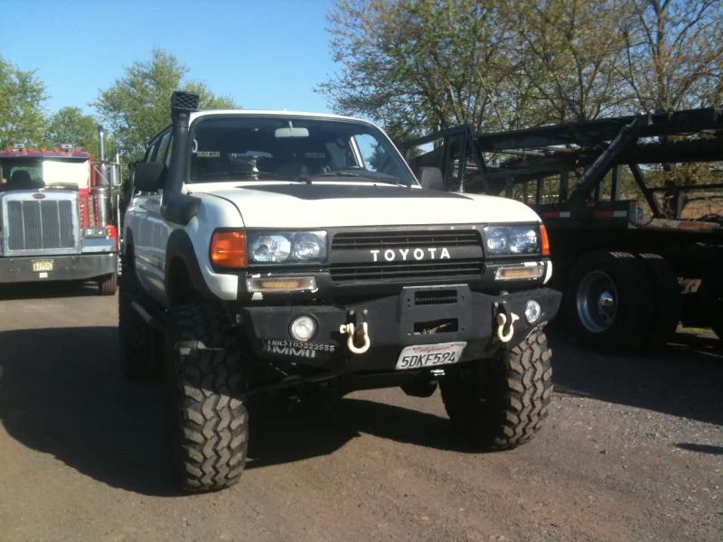

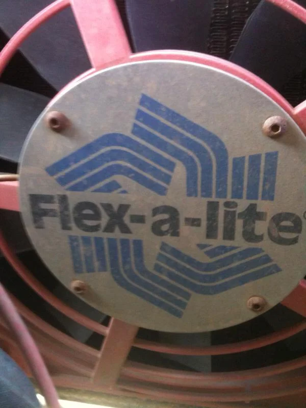

Guys,
I didnt have much time today to find the model number but I'm sure I can. I've got a list going that has to get done before I head out sunday on the cross country drive. But for now here is what I'm running and have been running for about the last 4yrs or so.
-Matt

I wanta say I have one of these...
Sport Compact Car Fans
Looks like they may have rebadged them to attract the import crowd.
-Matt
