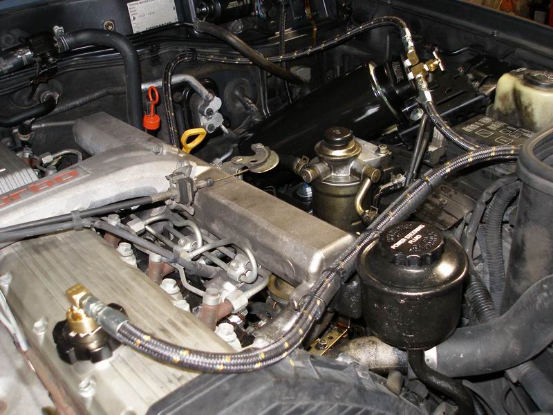

Has anyone used this or similar bypass filters on the 1HD-T's ?
http://www.worldsbestoil.ca/amsoil/bmk-11-by-pass-filtration-kit-installation.php
You can see the same thing here on the 2L in my LWB Samurai engine compartment. I would suggest removing the valve cover and drilling and tapping into it as opposed
to that oil cap as shown.....
I plan on doing to same thing to my 1HZ in my HJ60 but Ill be using the BMK-13 dual element unit.
http://www.amsoil.com/StoreFront/bf.aspx
Do you find that it makes a difference. If so in what way/how ?
Thanks,
Jesse
The simple physics of it tell you it makes a difference. Besides the fact that your oil stays cleaner longer, oil analysis says it makes a difference. The darn thing is filtering down to the 2 micron level! That's huge.
