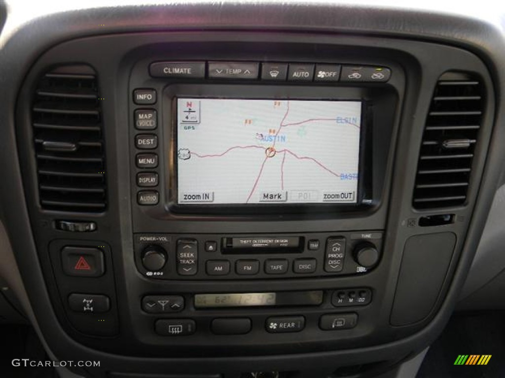

Also how do you tell nav or not? I mean mine has a nav. Maybe dumb question.
Not sure what you mean? If it looks like this, you have nav
