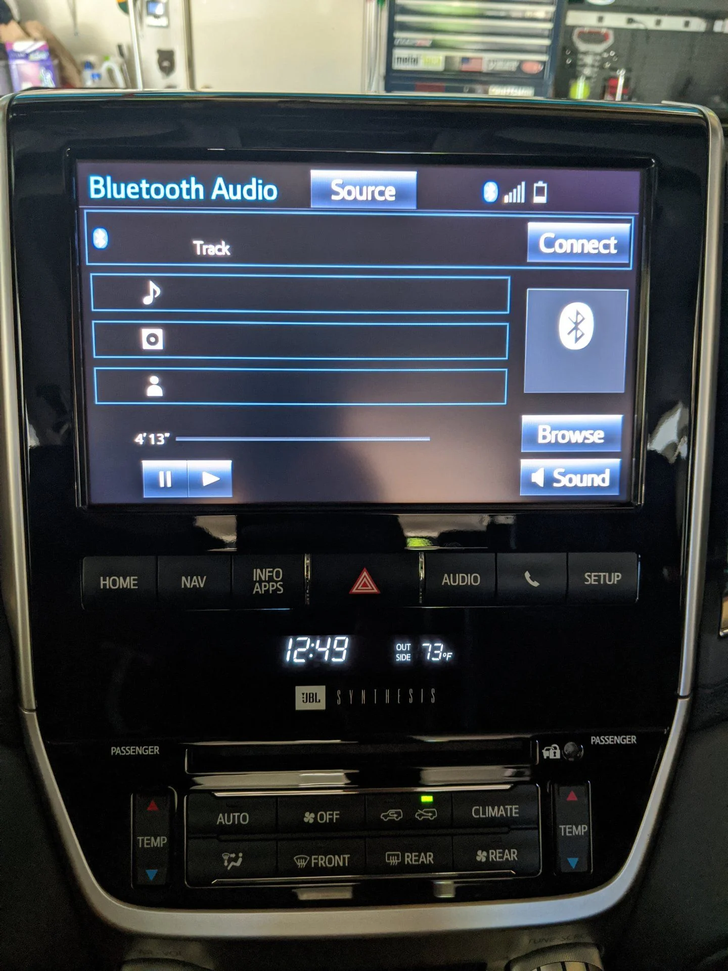

Been trying to get track info from Pandora to display and have been unsuccessful so far. Using a Pixel 2 XL (Android) on a 2017 Land Cruiser. I've connected to other Toyota vehicles the same age or older and had them display the info. Pic to show blank info. Any ideas??

any luck on this? I also have a Pixel 2 XL and have no song meta data displayed. Phone works on other vehicles with no issues. I have this issue on both my 2015 and 2016 LC.
I had this issue on our 2020 HE. I am using a Pixel 5 not a Pixel 2 but I thought I'd share what worked for me.
On your phone
Go to your Android Setting Menu
Then to System and select Advanced
You will need to turn on Developer Options
Scroll down to the Networking section
Look for Bluetooth AV/RCP Version
Change it from the default setting ( probably 1.5 ) to AV/RCP 1.3
Turn Bluetooth off then on for the setting to take affect. Reconnect to the audio system and track info should be displayed.

Hmm... I have a Pixel 3a XL, and I don't see anything for Developer Option in the Advanced Settings. I need to upgrade soon, my battery is getting tired. Trying to decide between the 4a 5G and the 5.

Look like every Android build is different, based on a quick search here's how you can enable Developer Options on the Pixel 3.
  1. From a Home screen, swipe up to display all apps.
  2. Navigate: Settings
    Settings app icon
    > System
    System icon
    > Advanced.
  3. Developer options
    Developer options icon
    Note
    If Developer options isn't available, navigate: Settings > About phone then tap Build number 7 times. Tap the Back icon
    Back icon
    to Settings then select System > Advanced > Developer options.
  4. Ensure that the Developer options switch (upper-right) is turned on
    On icon
  5. Tap USB debugging to turn on
    On icon
    or off
    Off icon
  6. If prompted with 'Allow USB debugging?', tap OK to confirm.

Huh, well look at that. Says I'm a Developer now! I'll let you know if it works on the screen now. Thanks!
