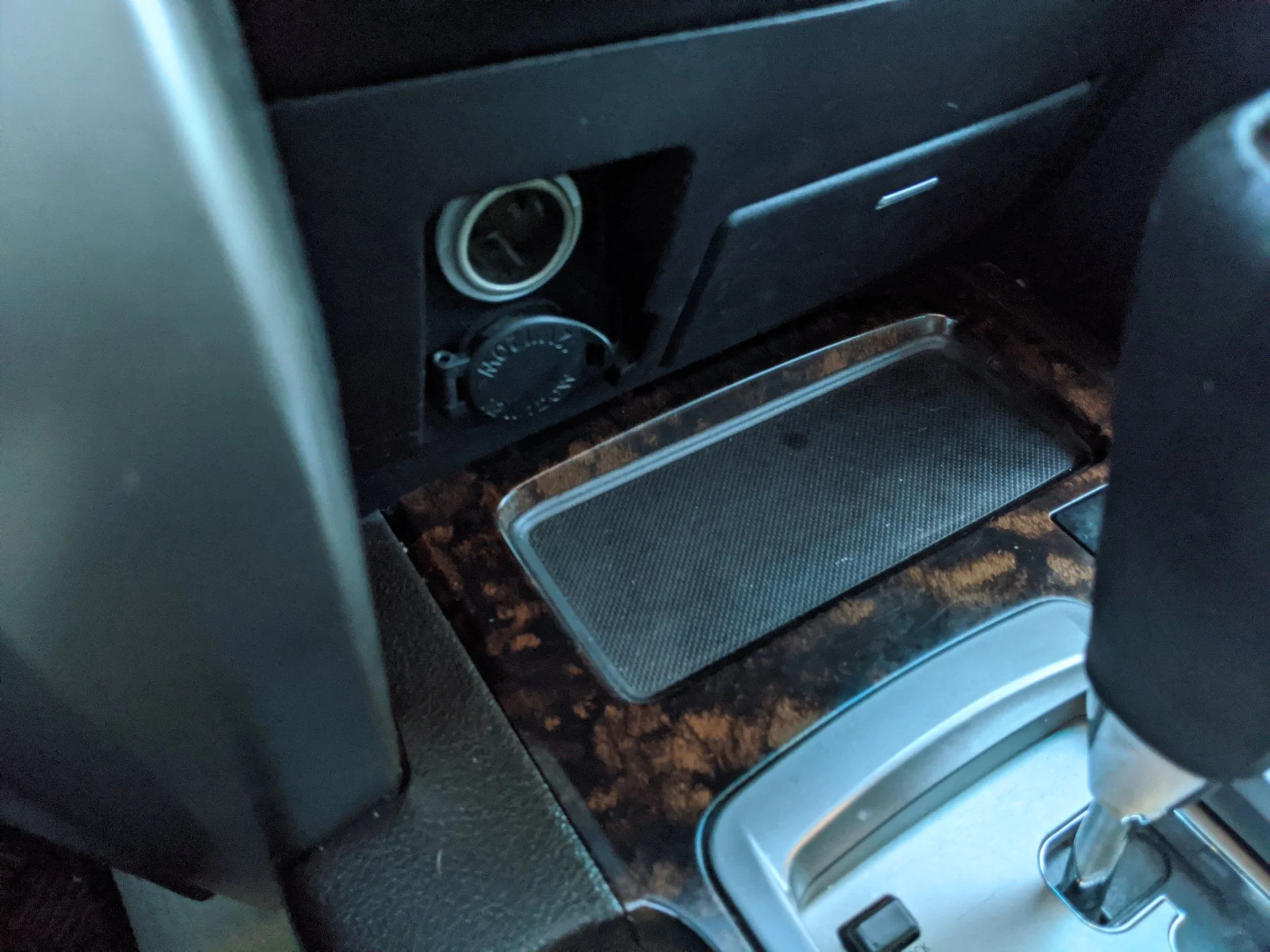

I don't have an aux port. If I had that I would just use an aux Bluetooth device.

Alternatively maybe I can retro fit an aux port ?

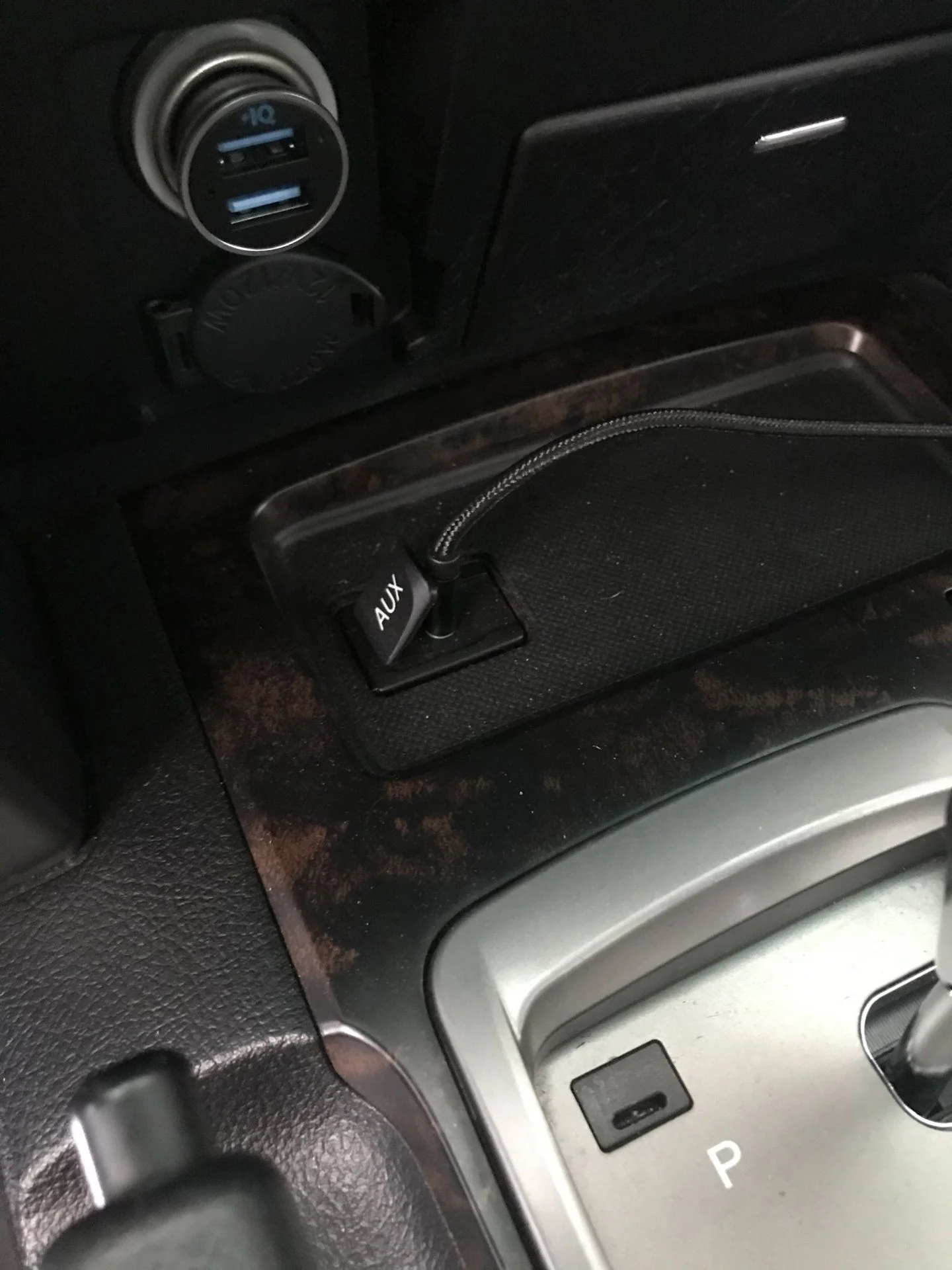

Really, you don’t have an aux plug in front of the shifter? I have an aux Bluetooth adapter and don’t like it so I just plug in.
Two things, firstly, I am surprised that your '08 doesn't have and aux port because mine does. Obviously it isn't there but I am surprised because I thought that was standard on all US LC's. Maybe the USB was a factory option and they eliminated the Aux port? Secondly, I am not of the belief that music streaming is available on the '08. I don't think that is possible on your version of Bluetooth but I don't remember why because it was back in '08 when I was getting mine set up.

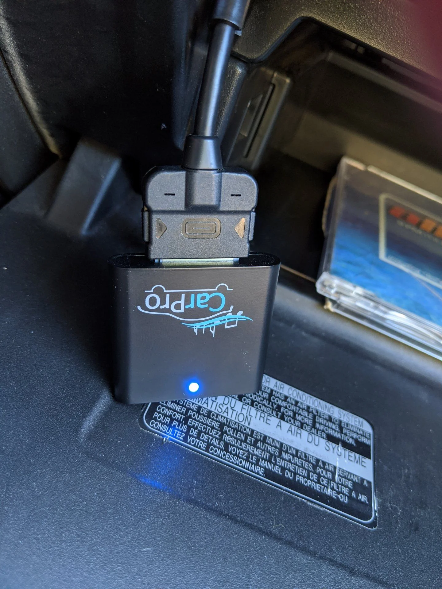

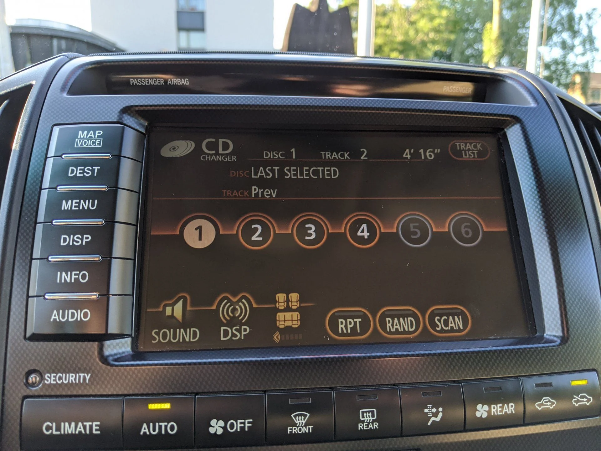

I received the Car Pro adapter and it works like a charm. I paired it with my phone and all audio is streamed to the car. I only have to select the CD player.
Sound quality is very good - 100x better than the FM transmitter I tried previously.
The adapter:
The CD player screen (obviously not needed to be on display all the time)
The adapter:
