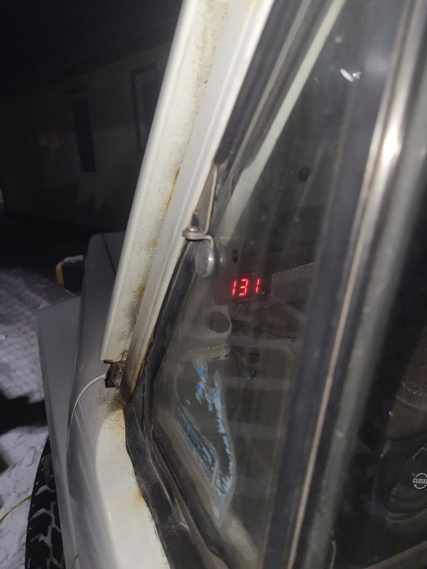

I'd say 130 degrees from a convection heater is a great way to start your day.
