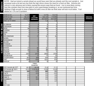

I wanted to run a report after adding the supercharger to see how things looked; unfortunately I couldn't find the oil sample I pulled, so I had to wait another 10,000 miles
Then I end up finding the last sample buried in the garage right after pulling this sample, so I sent them in together..
I may need to pull a 5000 mile sample to see if the new air filter makes any difference.
Any comments from the oil gurus?
