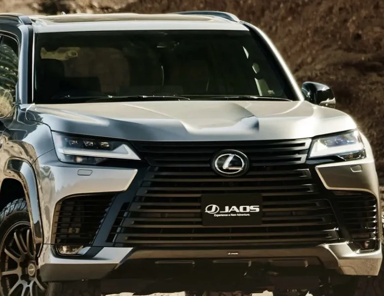

Anyway, I am wondering if anyone has seen a mock-up or (if it is easy to do) can create a mock-up of a non F-Sport with a black grill? I am trying to imagine how the horizontal slats would look in black….and I have a poor imagination…
I am also curious as to others input as to the best way to make the above grill black?

Lexus sells one with the appearance package and they have pictures on the website just like the one above.
Good thinking, not sure how I missed the most obvious answer. Thanks.

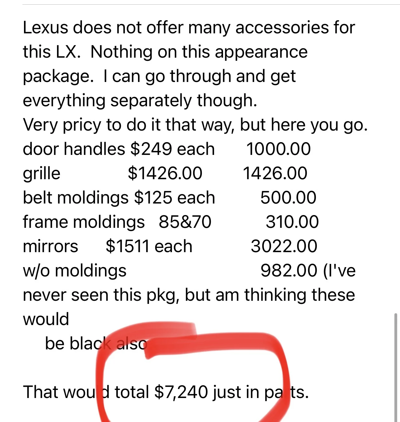

Follow-up question, is there a site where we can search and order LX600 parts?
Tried to find a site initially as I was looking at the F-sport grill. However, with the knowledge bomb Bomar dropped on me, I can just order the appearance package parts and swap them.
Problem is, I can’t find any sites that list the parts. I can even narrow it to “2022 Lexus LX600” but the results given are from previous models….
Dealerships can dig up the part numbers. OE parts diagrams with part numbers for new Toyotas & Lexus’ always take a long time to spread out to online sources on the web.
Got the parts prices….not cheap to convert after delivery. Additionally, the price below does not include the 18” rims.
