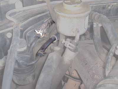

hello,
Just wondering if anyone knows where/if the diesel
water seperator is on the 13-BT fuel system? Pretty sure
it's called a water sedimenter. The maintanence schedule
states this should be drained each service.
Anyone out there got any ideas????
It's on the right side of the engine compartment next to the power steering fluid reservoir. It's located between the fuel tank and the fuel pump in the fuel circuit. "Draining" it is next to impossible, there's virtually no clearance under the unit to drain it, unless you don't mind letting it run down over the fender well and wiring harness. The simple method is to disconnect the sensor plug, remove the sensor, and then evacuate the sedimenter with a turkey baster. Refill the reservoir with clean fuel, and re-install the sensor. It can be seen to the left in this poor photo.
thanks john,
I was looking round under the bonnet yesterday and saw it and wondered what it was. Is it necesary draining or should I wait until I see the filter light on in the dash? Is this something I should worry about doing? Sorry for all the questions but I have been servicing the cruiser myself and don't want to miss anything.
Thanks for helping out.
Gav
... Is it necesary draining or should I wait until I see the filter light on in the dash?
In my experience when you see the light it's too late and usually at an inconvenient place and time.
Is this something I should worry about doing? ..
Not a cause for worry, just part of normal routine maintenance. I usually empty the sedimenter in the fall before freeze up, in the driveway where it's a lot more convenient than at the side of the road at minus 30.
Glad to help; you've got one of the very best cruiser models ever made. The vehicle of choice for Afghan warlords. Treat it right and it will outlive you.

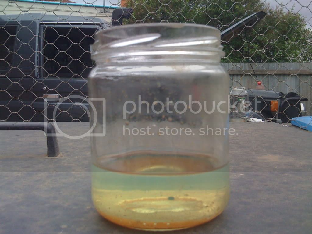

Hi John,
Thanks for your info mate, it made the job heaps easier. I replaced the fuel filter at the same time so the engine should be getting nice clean fuel.
Heres what came ou of the sedimenter.
Some brown gunk and black crusties as well as a bit of water but mainly diesel.
