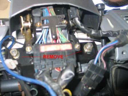

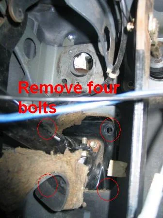

Remove the four 12mm bolts holding the steering column to the firewall.
Remove the two 17mm bolts holding the steering column to the dash.
This allows you enough room to remove the booster without removing the clutch pedal and steering column
Good luck :)
