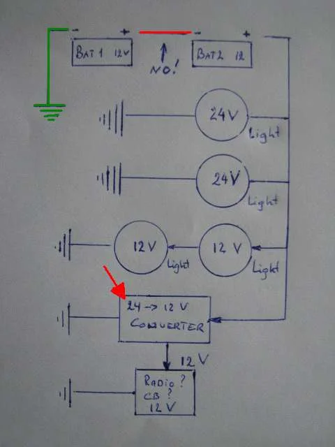

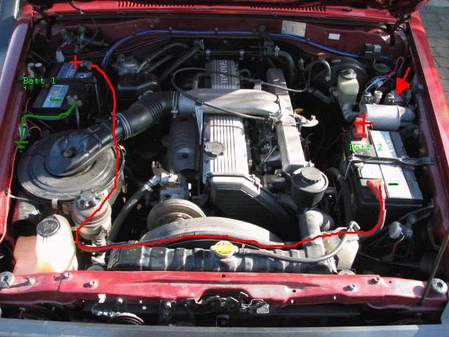

I promised to post a picture and diagram, hopefully to clarify.
Here they are:
on top: overview of my engine bay.
Clearly visible the two batteries. The red line marks the (fat!!!) cable that connects battery 1 and battery 2. The green line marks the cable to ground.
Second picture is a diagram.
I used the same indications in both pictures.
Where you see the word 'NO' at the top, the arrow is pointing to the connection between the two batts.
Because the batteries are connected this way we say they are connected in series. Thus there value( each is 12V) is added, providing 24V to the system.
Nothing should ever be connected to this, be it at the cable itself or the terminals (there is just one exception - a balancer - but we will leave that out of the discussion as not to unnecesseraly complicate matters here).
BTW the 'arrow' is a symbol that stands for a ground connection.
From the diagram you can see how a 'normal user' is connected. For example two 24 lights (could also be a wiper motor) each light is connected to the 24 V source. In real life there would be an on/off switch somewhere, for clarity I've left that out.
Here we say the two lights are connected in parallel. Each light has it's own connection to +24V and ground.
Then the two 12 V lights. As you can see only one light is directly connected to +24 V. The other end connects to the second light and the second light connects to ground. We call this in series. Very similar to the batteries.
Nothing wrong to do it this way. Drawback is that, if one of the lights fails, the other one will not function, because the connection is broken.
Last item is the 24 to 12 V convertor.
All this thing does is transform the 24V system voltage into 12V. This then is a 12V source for 12V equipment like standard car-radio's, CB's etc.
Normally this converter is connected to the 24V system through a relay, that way that the convertor is disconnected when ignition is 'OFF'
This is because these convertors tend to draw a little amount of current by themselves, thus draining the batteries over time.
Hope this clarifies the basics a littlebit.

But bear in mind, an equalizer (or load balancer) is not a 24-12V converter.

Many thanks for the illustrations and explanations! I think I'm pretty close to grasping it now.
You're welcome. Glad I can help a bit. Wish could do more.
