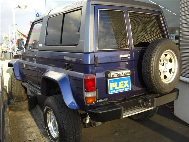

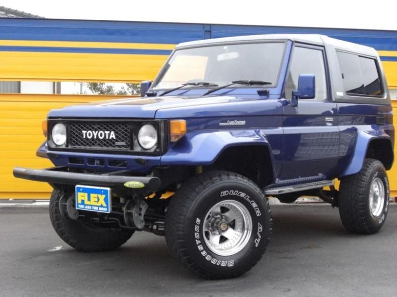

I found this one masef....:D
Ohhh The pain !!!! I gata wait a month and a half befor I can even see it:crybaby:
What does the V stand for ..?
And I never seen so many zeros in a vin number..

nice! them are some funky shackles! but very nice 70. What is it?
it being the truck well as far as I know it is a 1985 BJ73V and I have no idea what the V stands for ??
And the fenders I have no Idea and I have never seen another Land Cruiser with any thing even close ..
Its the only reason I bought it and the fact it is a Toyota Diesel ..
It was all I could to to make the choice to buy a import for a truck.. I have had domestic all my life ...

Hi WILD FX , Nice 73, I like the color, I was noticing the leaf spring shackles you have ( under the front bumper) those are real heavy duty ones, just a word of advice, if you want a better ride I would get Old Man Emu shackles. Those shackles that are on it now are verticle and because of that it is harder for them to move forward when absorbing bumps.
just my 2pennys. Nice Unit,

Shackle brand won't impact the angle that they sit at or the quality of the ride unless your choosing between greasable and non. A longer shackle however will allow the heavily arched spring to flex more readily. FWIW I think the ones that are on there look kinda cool...except if that centre pin is for anti inversion, then they're on backward. Nice truck.

Its possible they are the factory f/g flares fixed permanently.
Hey nice looking ride. Those aren't rancho shocks, there pro comp es9000, nice shock but not manually adjustable. And those shackles have pins on both front and back there for strength and anti inversion, oh they should have grease nipples in them too.
Whats that tiny lil Knob for ?
And yes the pins are on both ends and also have extra positioning holes ..
