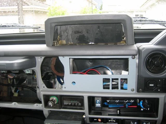

For my dash a buddy made me a new plate, holds a deck and has cut outs for ARB and aux light switches.
Pyro + boost gauges will go in the dash pod, making a new plate for that too.
