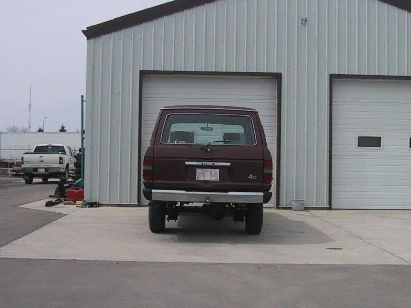

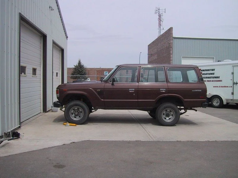

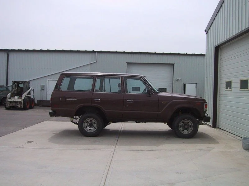

Well, I finally decided to get the OME heavy kit from Cruiser Outfitters. Kit installed smoothly even without instructions. A quick search on mud to make certain the A rear spring was supposed to go on the drivers side and that was about all that was needed.
The ride is great. I was worried that it wouldn't lift it enough for my tastes, but I have to say I am pleased with the height. For those of you who have read up on other OME installs, the slight rake (aka stinkbug) is no surprise. Also, the driver side is slightly higher (about 1/2"). I'm a lightweight, so this probably doesn't change when I get in :)

The A spring was noticeably different to install than the B (shorter/more arch?). I had to do various stuff, like compress it with a jack under to get it bolted up, whereas the B spring just lined right up without any effort.
Not to high jack..but. the Passenger side A spring slipped right in. No twisting and prying. Of course had to use the floor jack to move it up and down. but no problem pinning it etc. Sits level now. Has been on a year w/ no settling. Made me a much happier camper..Hell My rig did not "lean" before the lift. It sat down a little in the ass but no lean..
I re-measured mine, and the rear is pretty level at its current resting spot.
Rear measures: 35 1/2" driver, and 35 1/4" passenger (from ground to fender)
Front measures: 35 3/4" driver, and 35" passenger
It's too early to make any conclusions as I've only driven it twice since I did the install on Saturday.
