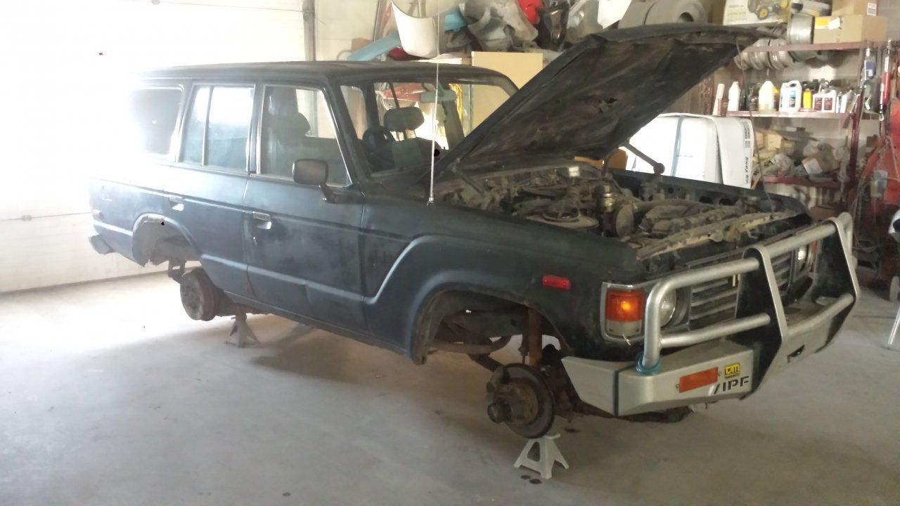

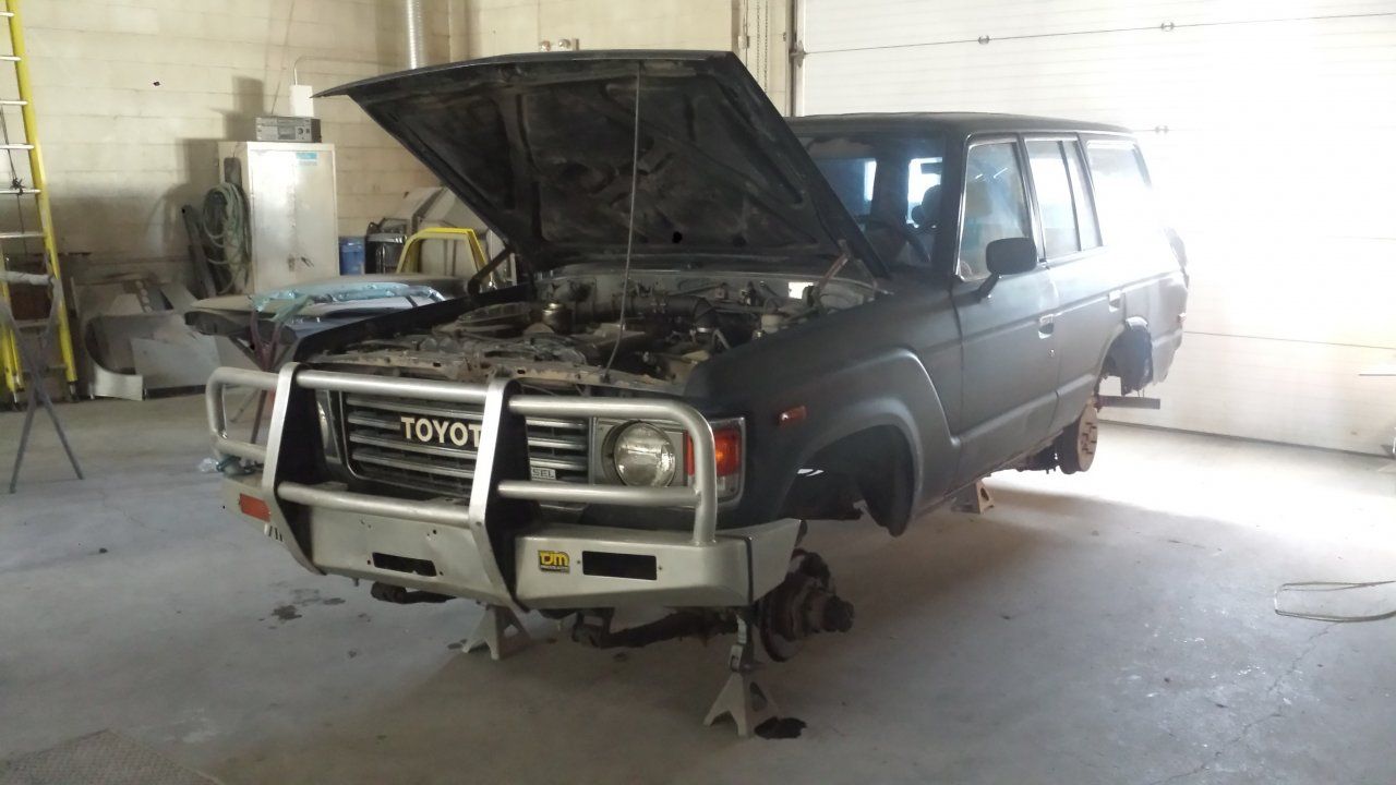

Now to the meat and potatoes of my new registration to the site. I have got two project trucks that I got my hand on in the last year. My first project I procured is a 1985 BJ60 with a 3B that was a rusted out piece of crap but the drive train and interior was in excellent condition. View attachment 951204 View attachment 951206

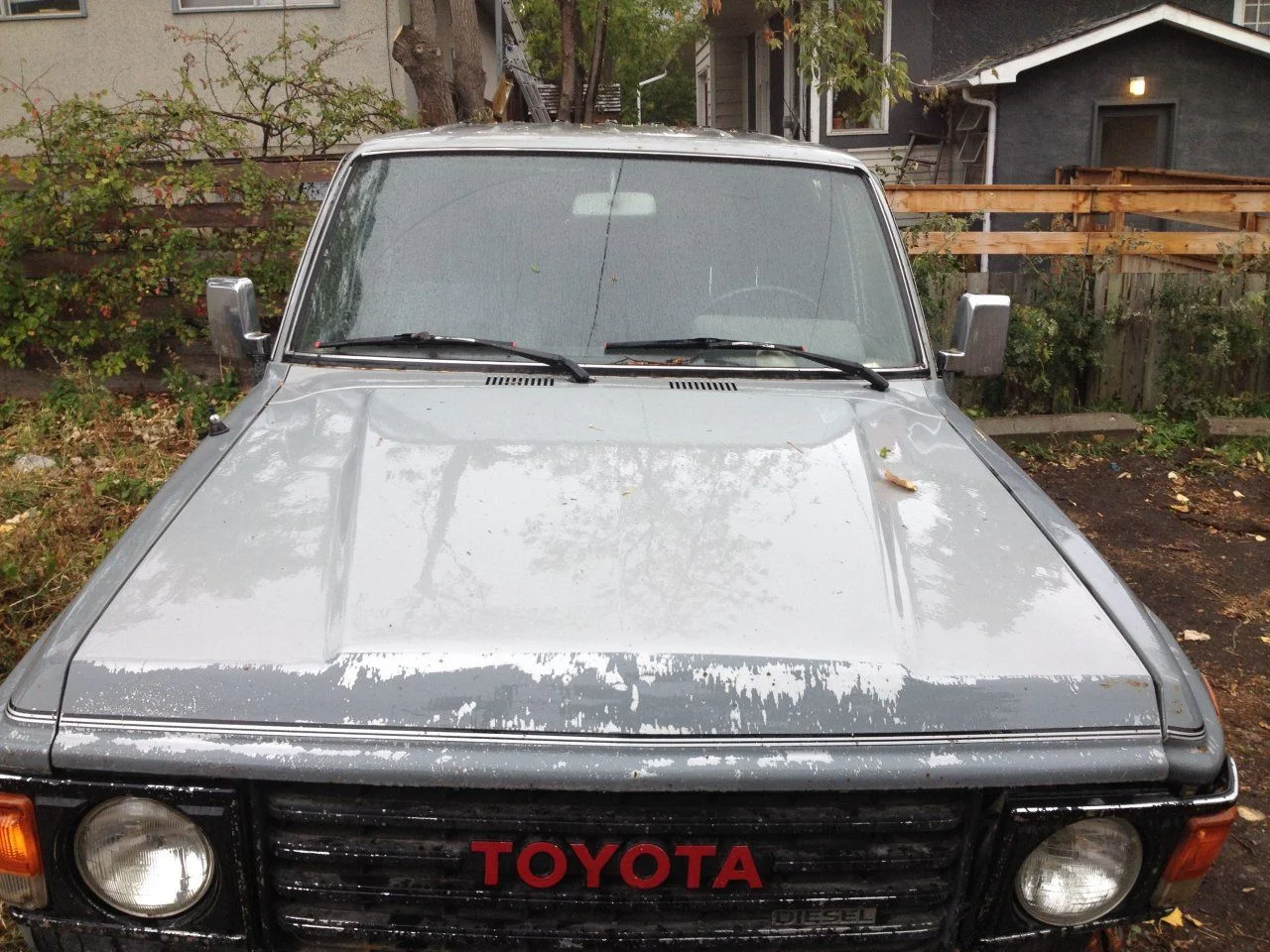

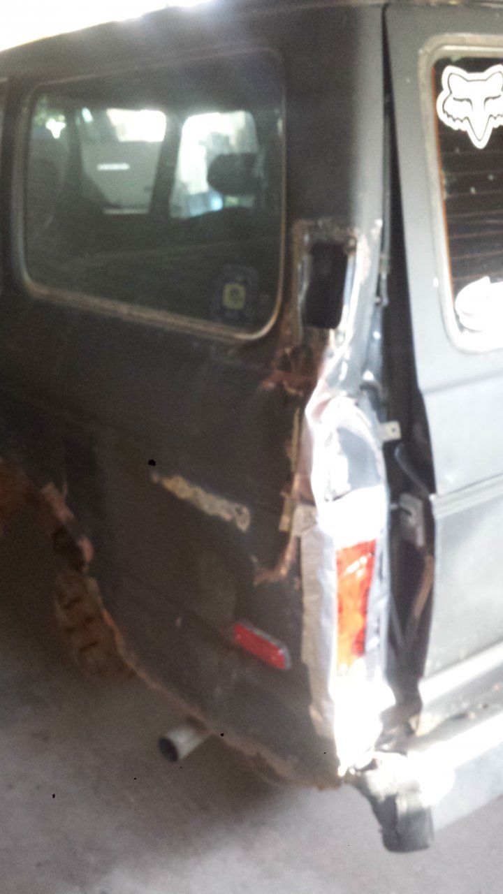

Had a pretty great time driving it around for a couple months until I had a run in with a pole. Literally.View attachment 951209 Kinda discouraged me and I left it alone for awhile. It was only last weekend that I found a suitable donor vehicle that I was going to steal the body off of. It's a 1986 Canadian HJ60 and is pictured below.View attachment 951219 View attachment 951220
It is in better shape believe it or not. Catch is that the 2H seems to have a broken piston ring as it smokes like no ones business. Anyways, unbeknownst to me until pick up, this HJ has a 5 speed H55F which is a pretty big temptation compared to my 4 speed 3B.

- 1985 BJ60, 3B Diesel engine, 4 speed, 380,000 Kilometers, quite a hard life by the look of it,
- 1986 HJ60, 2H Diesel engine with some troubles, 5 speed H55F transmission, 615,000 Kilometers, at least compared to the BJ60 and the little the previous owner told me - seems to be better taken care of with less 4x4 on it.
