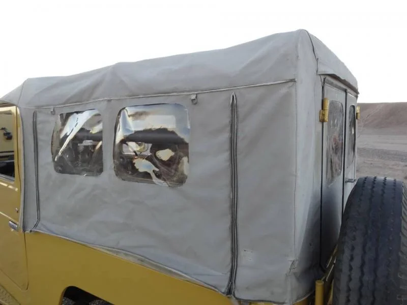

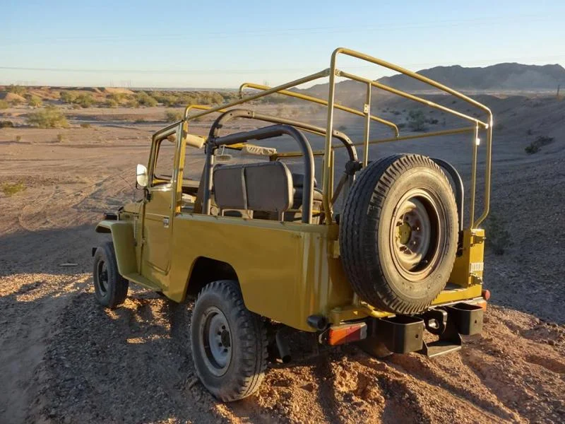

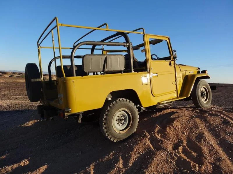

I'm thrilled to say that I've finalized the purchase of a 1979 JDM 100% stock RHD BJ44 (pix below) from CC Cruisers.
She's shortly on her way to the East Coast and while I love the idea that she's 100% stock, the one change I'm contemplating is power steering. Whether or not I do it is dependent on price/hassle.

Can't offer much other than hat specimen deserves OEM treatment.
Congrats. Glad its off my local Craigslist now :D
Keep us posted on it. Looked like a nice cruiser. Just wish they wouldn't repaint a truck in such stock and low miles condition though it looks great!
