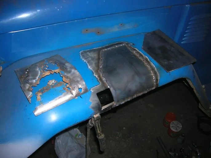

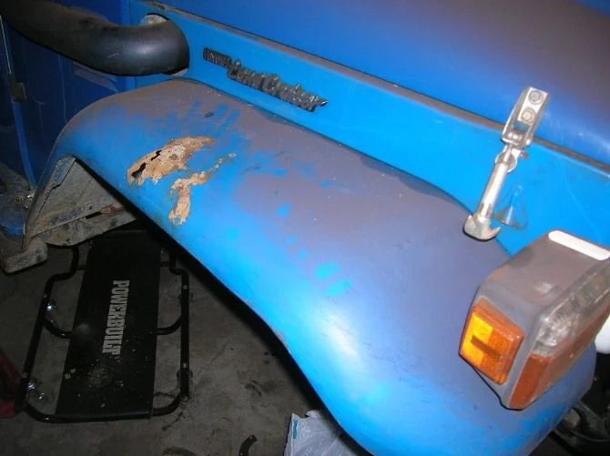

Here I fixed my rusty fenders, which every couple years would have to wire brush and rebondo, so hopefully this will be the last bondo job until I have the money to buy new fenders.

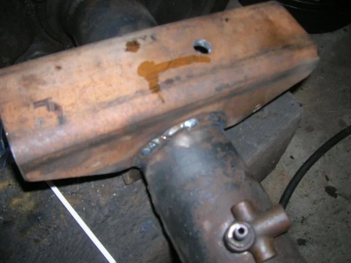

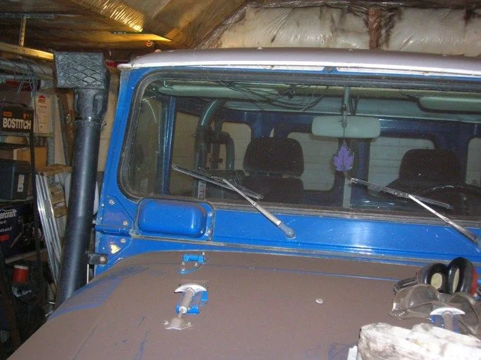

Chopped my snorkle by around 4in, because I was tired of grabbing branches with it, I know it won't completely eliminate the problem, but will help a lot.

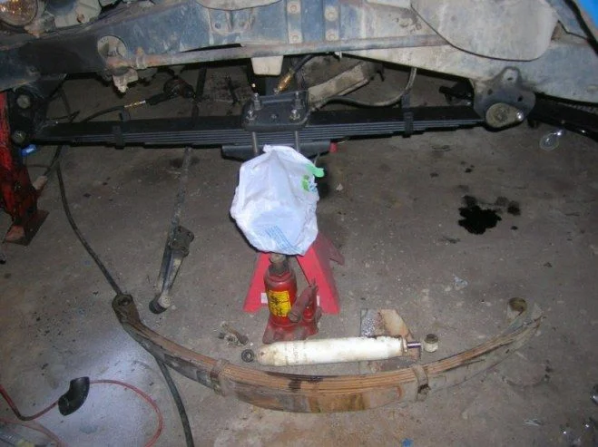

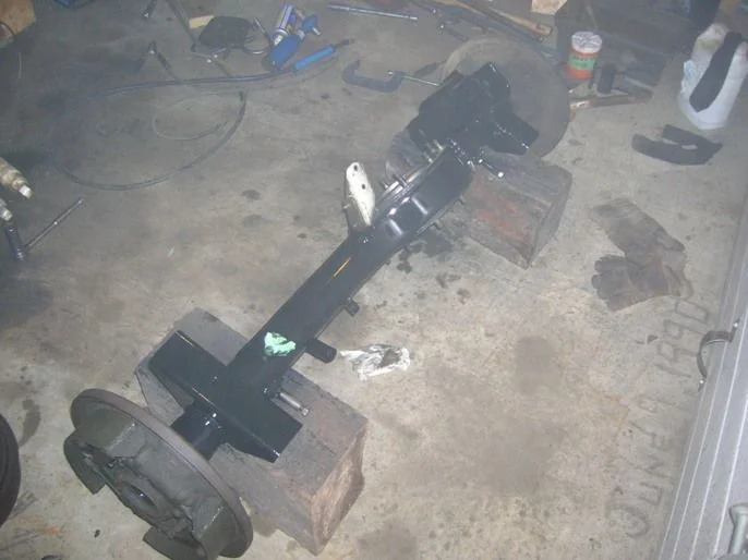

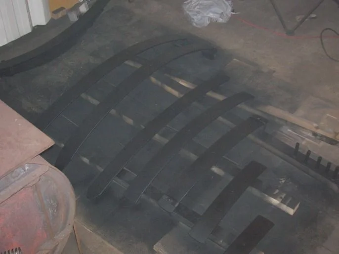

This is why this soa job is not a quick one, I had to take my springs apart, clean them, paint them.... damn it I never take the easy way.

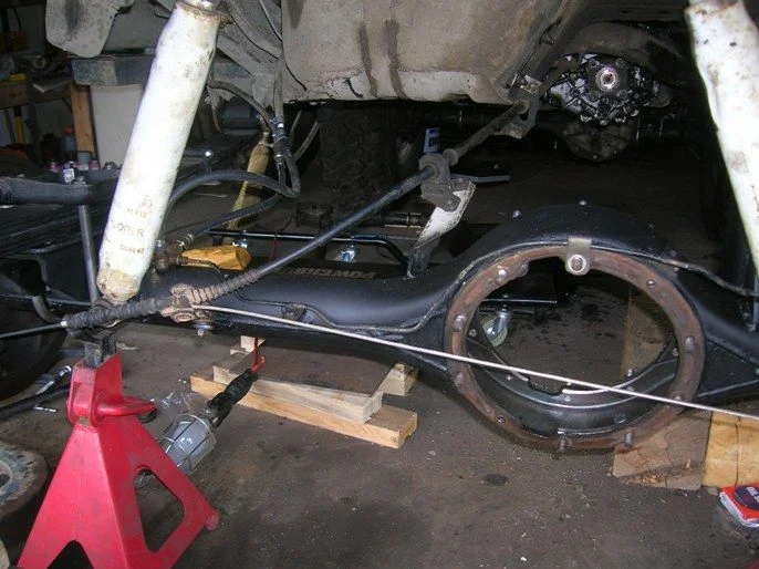

Here is how my rear suspension sat. I will take a picture after I am done to see the clearence I gained, but measureing the spring thickness, spring pads, and ubolt plate is about 4inches, so with the same tires, it will go from 10 to 14 inches of clearence and no ubolts to catch on.
The main reason I went soa was because I wanted to do a ubolt flip, then in the last year, I had inverted my shackles both front and rear, and tweaked the springs requiring me to do something about it, I decided to go this route. Will probably use the 3in springs, once I fix them up(get the kink out) on my other BJ42, but that is a whole nother story.

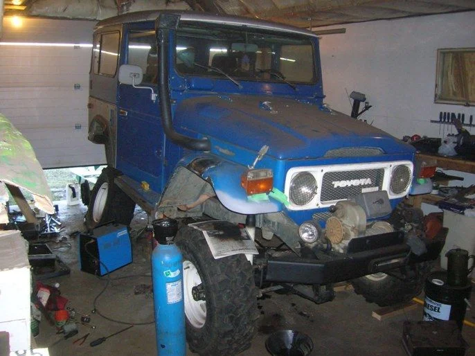

This is where I sit now,
I am springing over the rear, made some homebrew spring pads. They sit a bit high, but I would like to see my back end a bit higher, especially once I load it up with stuff.
I know, even now when it's 11 deg outside, it's still cold in the garage, I don't want to start a fire in the stove, so while outside in the sun it's T-shirt weather, inside I wear a jacket and gloves.

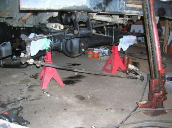

Decided to take a pic of the whole truck to show how high I had to jack up the rear end in order to roll the rear axle back so I could weld up the perches. All I can say is that there is a lot of droop, and am glad I lifted the ceiling in my shop, or I might have had problems.

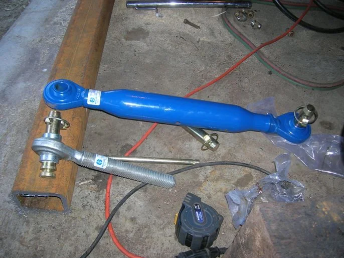

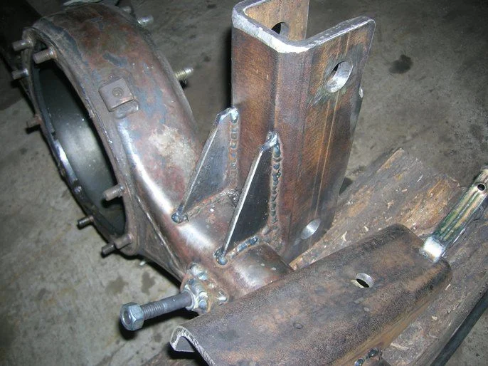

So I welded up the perches, and bought the farm equipment to do the antwrap bar. Looks a little too beefy, but I guess you can never be too cautious.

That is where it is sitting at now with the springs drooping, and I had to pull the rear axle out with the tires on, when the truck is sitting on the axles in the rear, it will drop a foot or two. And it will be tight getting out of the shop, since I only had an inch to spare before, so I will have to either air down the tires or swap my 31's off of rusty.

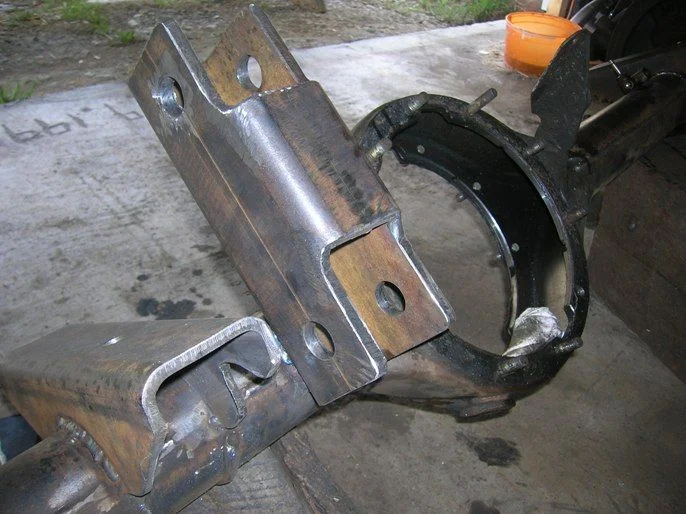

Didn't do much this weekend, but still messed around with it for quite a bit. Thought I ran out of gas, but today when I went to take the bottle to get refilled, it seemed heavy, so I opened it and tons of gass streamed out, checked everything, and looks like the gauge does not work, damn it what a waste, could have had the rear brackets all welded up and painted.
altleast I have everything fabbed up, just got to finish welding, and finish building the antiwrap bar. Sucks though, I killed my drill, couldn't find the reciept, so looks like I got to buy another.
These pics show the shock mounts, which are done, and the start of the antiwrapbar mount for the axle. The rest of the time I cleaned the shop a bit, measured for the AWB, and helped Kim put the engine into Jodi's oldschool Bronco.
Yesturday, got back to welding, finished the mount, and added some braces, then gave it a quick spray. I heard from a Jeep guy that some antiwrap bars can rip the housing apart, so I spent some time adding lots of welds. Don't know if it's just a Jeep thing, but didn't want to take any chances.
