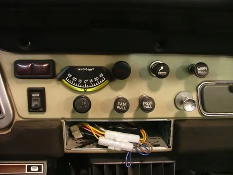

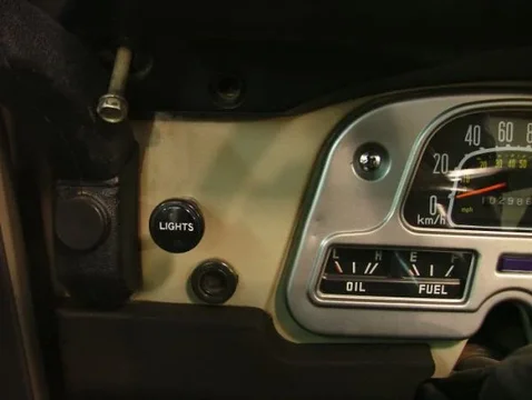

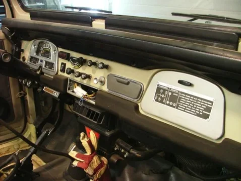

brmFJ43,
Please find attached pics of my 12/79 BJ40. There is only one knob that is aftermarket, the others should be stock.
LHS: Lights, Glow plug indicator
Middle upper: Brake / Fasten Seat Belts indicator, Aftermarket lev-o-gauge, Hazard (upside down), Cigarette lighter, Warm Pull
Middle lower: Glow switch, Wipe Wash, Fan Pull, Fresh Pull, Aftermarket knob.
Don't know if this helps. Hope so.
