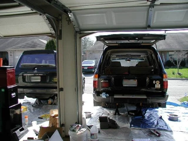

    It does make sense to work on both sides but in my case, the limiting factor was space that's why I can do mine one at a time and thankfully so. But here's a pic of Beno and Rookie2's rigs with the rear taken down:
    https://forum.ih8mud.com/attachment.php?attachmentid=15862&stc=1
    I've repacked both front axles and the process is pretty straightforward. It really is energy sapping so that could be a factor also. But one thing I would be very wary of is the possibility of missing out a few little things. I remember that I was about to put back my tires in when I saw the other nut for the brake caliper. I mounted the caliper with one nut to insert the brake pads and then proceeded with the rest of the axle. That would have been a very costly mistake not to mention life-threatening.
    My .02, unless we've done this countless times and we've a mate to help in the repack, I'd do it one at a time. As a newb, I'd live by that.
