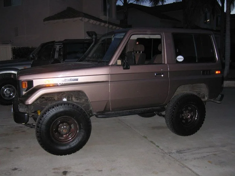

Greg, we kept the srpings as shipped when we install them. Jan is running BFG AT 33x10.5x15 no issues. Jan is still running stock 3.70 gears Here are some pics of Jans (brown) my BJ74 with belton and BJ70RT with belton both running 35" and 4.11 gears.
Cheers,
Michael
