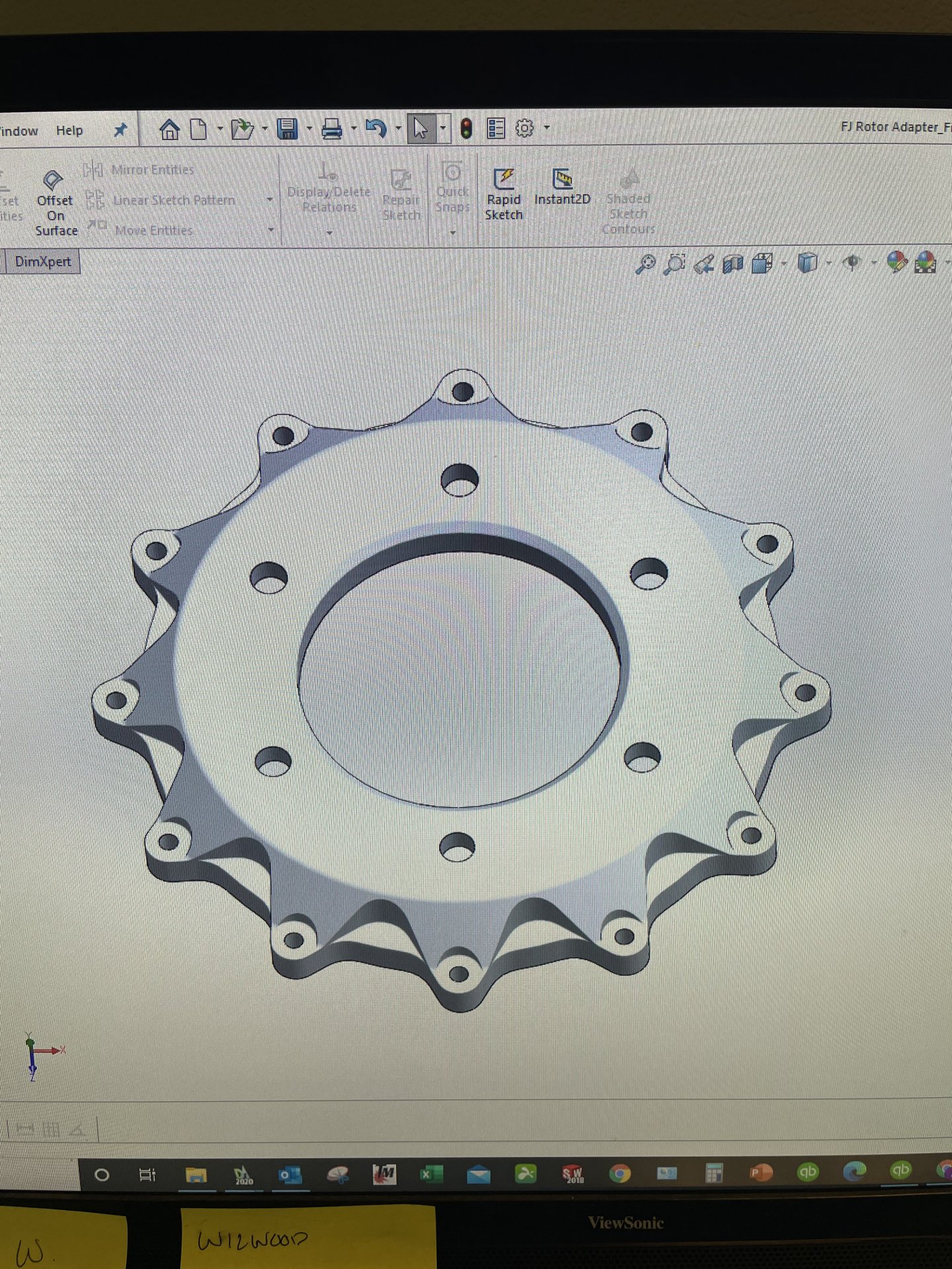

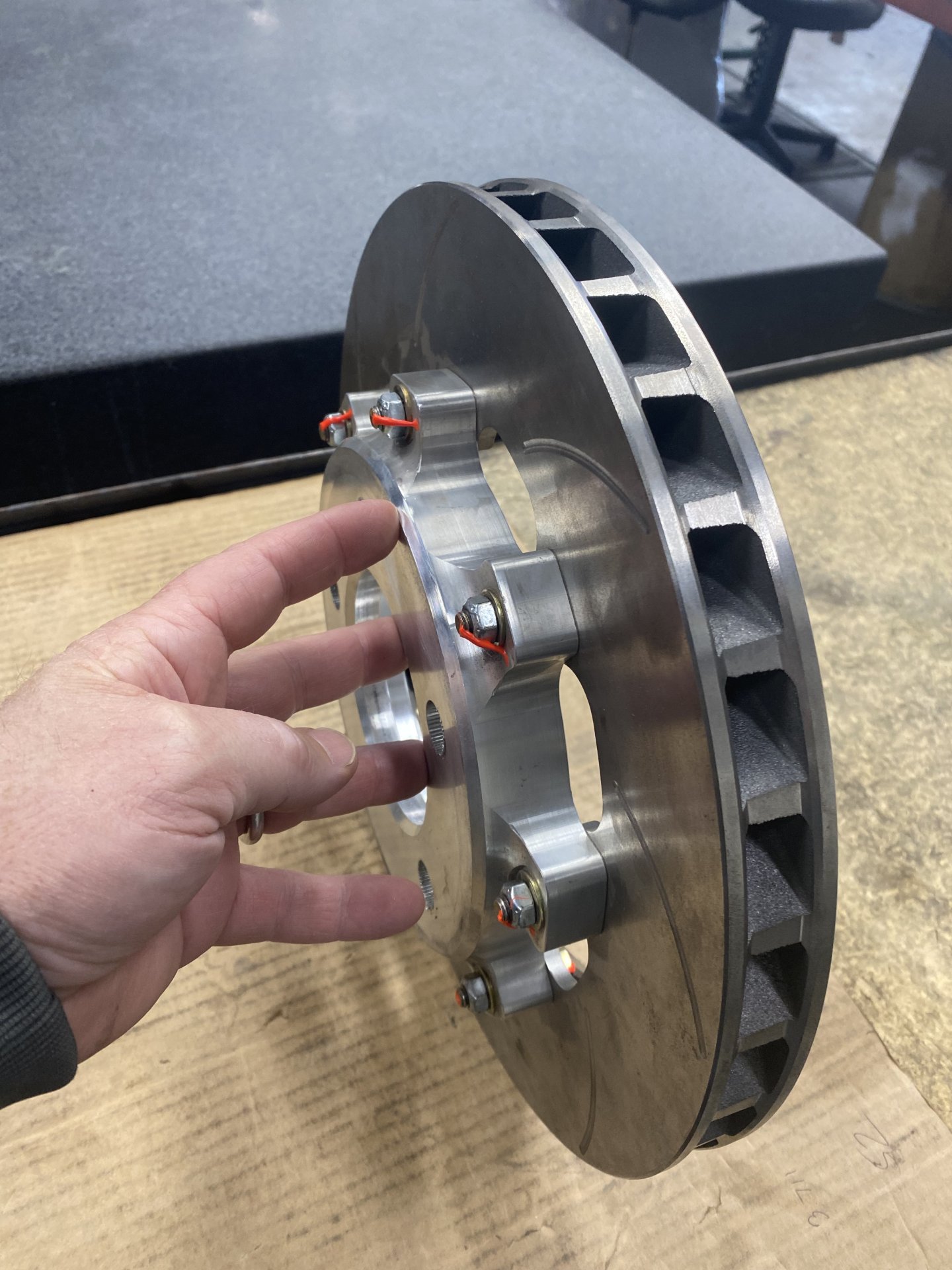

I’m designing a big brake set up for my 80. Using 14” rotors and wilwood 6 piston calipers. Once I get it finalized, I’ll post pics and performance feedback. Stay tuned. Pictured a set up we made for a 90’s Bronco.

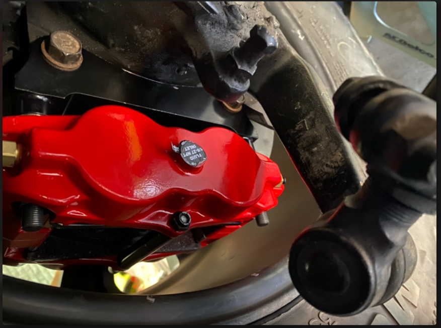

I run Tundra 14" rotors and the Wilwood 6 pistons narrow superlight 6R's up front. 18's fit and 17's will be extremely tight but haven't tried them. Wilwood states nothing less than 18" on their website but that's in reference to the kit I butchered.

I would actually be interested in rear. Maybe once my front rotors wear I would entertain the rotors IF you can make a slightly different offset(changed to slip fit rotor design). Looking like you make the hats in house?
Here is the clearance I had when I fitted the 18's. It may be possible to squeeze another .5" of clearance there assuming your looking at the same calipers. Guessing if you don't make 17's work, you will get very little interest. This crowd likes their 17's!
