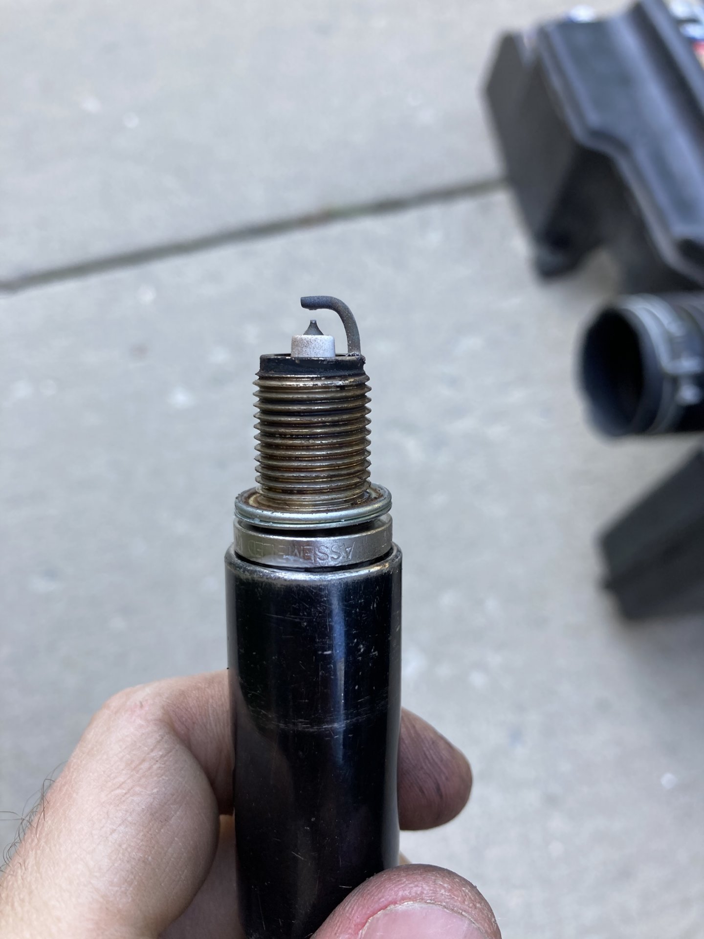

I decide to pull coils and check plugs, here is where it gets interesting- all seven of the plugs I purchased from eBay (I dropped one, bending the ground electrode so I knew cylinder 1 had a Denso from Advance in it, this was replaced at same time as others) had rounded or missing center electrodes. I don’t know how it ran as well as it did for as long as it did, gas mileage is always norm, +/- 13.5ish around town.
The Denso from advance was literally fine, I can only attribute the premature failure I experienced to counterfeit plugs. It’s simply too coincidental that all seven would look this way except the one plug I knew was legit. Just FYI- don’t save a few bucks and make sure you source plugs from reputable seller. Photos attached of two of the bad plugs (all look identical) as well as a shot of the lone good plug. Crazy stuff!
