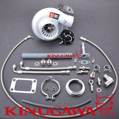

It seems when it comes down to getting a turbo for a 1HZ/DT engine there is a lot of choice and certainly big price differences ranging from 200$ for cheap Chinese knockoff CT26's models to +2500$ Gturbo's. I am not looking for high performance but just some help to pull a trailer over the highway at highway speeds ;-) and will ad a top mount intercooler.
Right now I have been looking at the Mamba and Kinugawa turbo's but their are a lot of choices to make for size and boost.
Are there people here running these that are not interested in zero to 60 time but care more about overall performance and keeping everything in one piece ? I have a super low miles late model 1HZ in my cruiser and am not planning to replace it anytime soon
Some of the turbos I looked at on Ebay
It seems that going to a smaller turbine makes it spool up faster and will help me more in the mid range then the larger ones.
Smaller exhaust housing will aid spoolup, but a smaller compressor housing can choke mid-top end.

If you're looking at the mamba or kinugawa options, turbine size is not the only factor to consider for spool up.
The one you like in your first post has a 9 blade turbine. This will take a little longer to build boost, or will need a hotter tune to get it to spool, but at higher RPM won't choke because it's less restrictive than an 11 or 12 blade turbine.
11 or 12 blade turbine will spool up earlier, but will restrict top end flow a little more.

Found out that one of the guys I know works for a local shop that specializes in performance turbos and they quoted me 275$ to rebuild the 1HDT turbo so I might just bring a 1HDTFTE core with me from Europe and have it rebuild, I know a shop that has a crate with around 50 cores sitting in it and last time they asked me if I wanted some ;)
