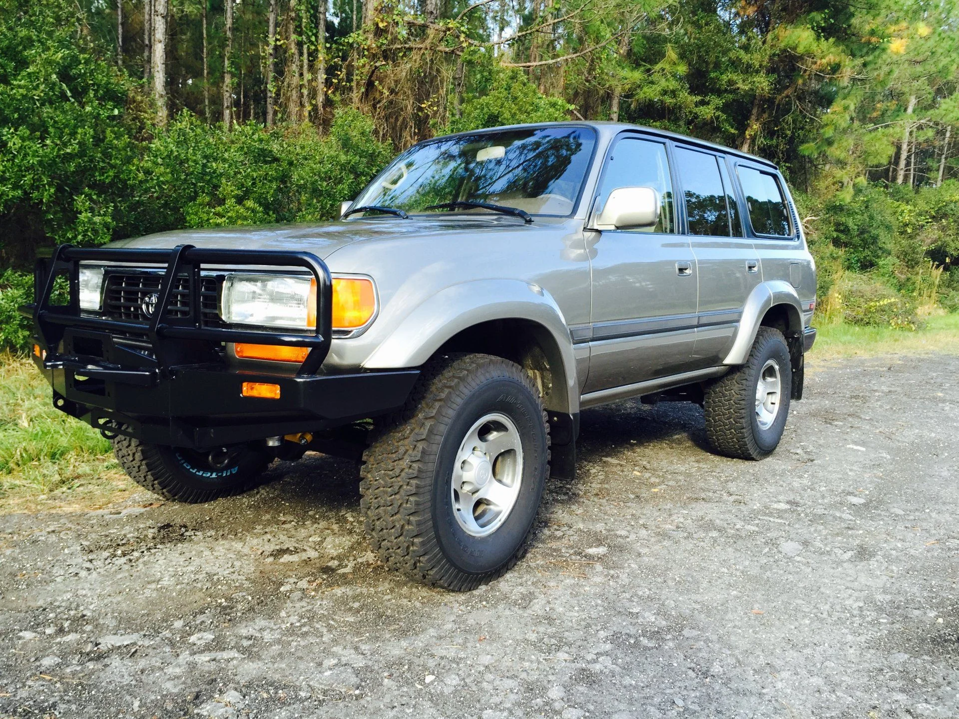

Pictures of my baby (Betty)
Stock height or 2.5" OME Heavy?

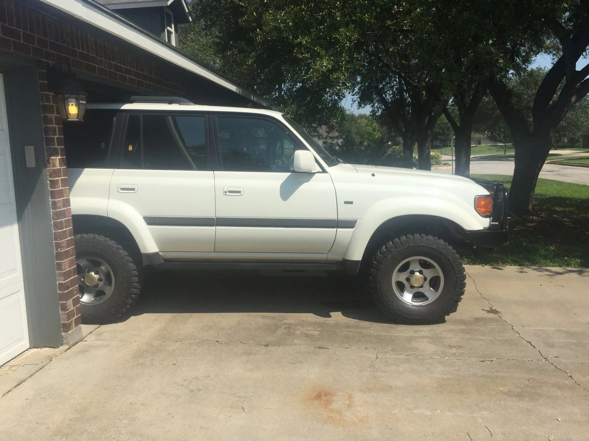

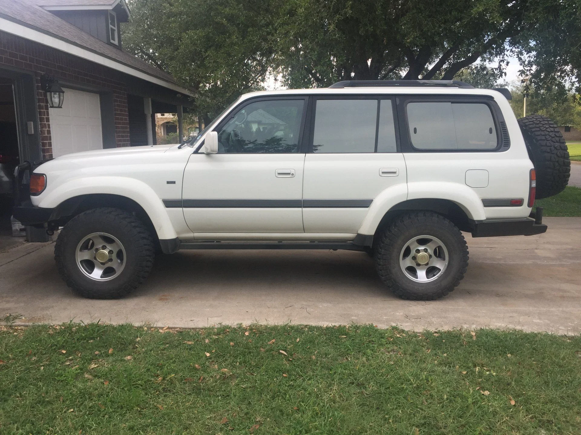

I have the Icon Stage 1 and love it. I have ARB front with 12k winch and IPOR with single swing on the rear, 285 tires. Other than that I'm unloaded. It soaks up the bumps very well. It appears to be much higher than the 2.5" just from the pics I've seen but it is marketed at a 3" kit. There is a slight amount of stink bug, maybe .5"-1".

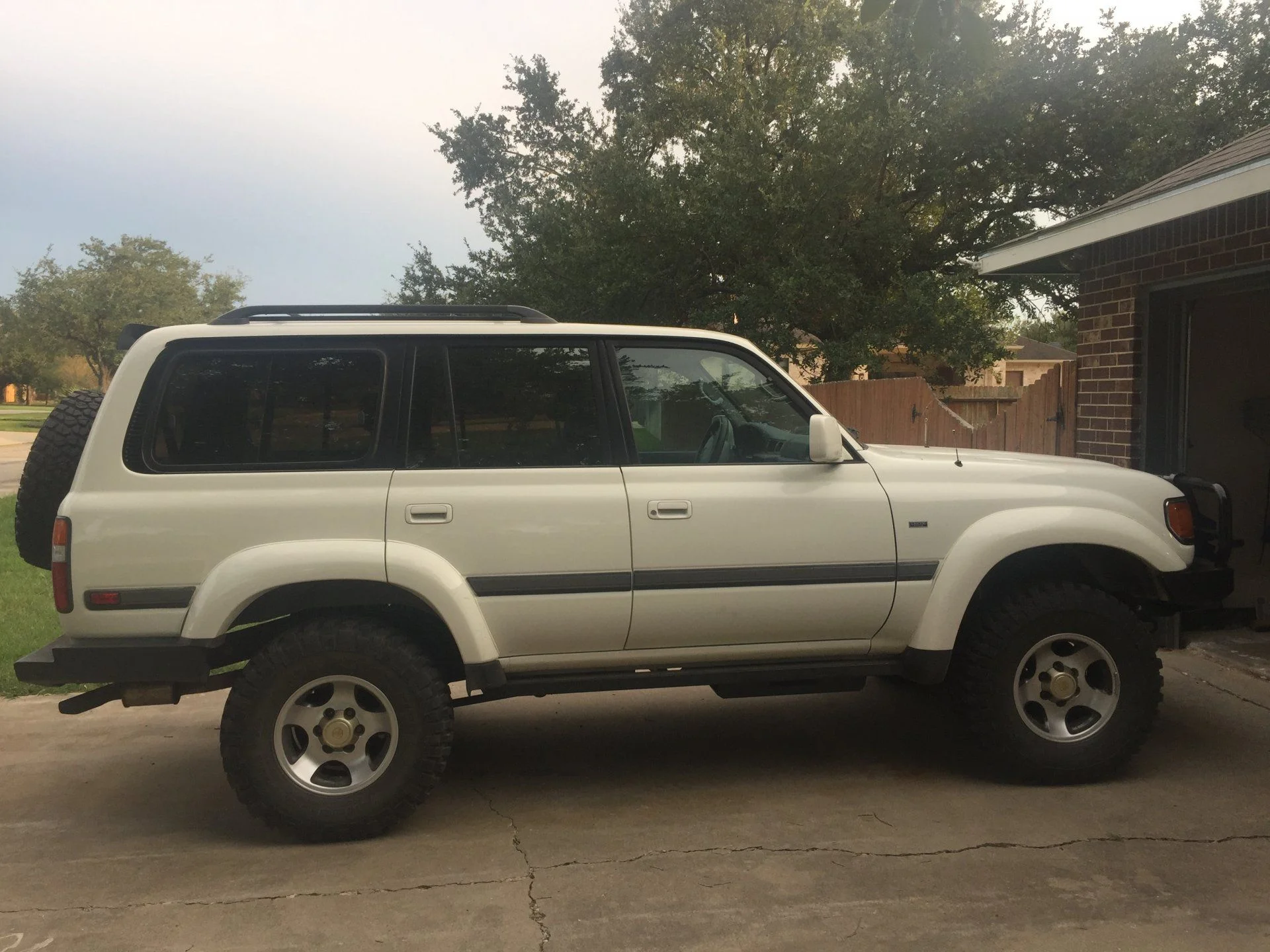

I have a Tough Dog 2" spring suspension. With 41mm foam cell shocks. It is the "light" version meant for 0-600 lbs, IIRC. @reevesci can chime in specifically.
I have been very pleased with it and spend a lot of time on washboard gravel roads.
My everyday weight in the backend is a wood sleep platform, 50lbs of tools and parts, and a fridge. When I had it loaded down it rode even nicer. I know @mervo has the progressive springs and loves them. But he has a rear bumper with dual swing out and storage.
