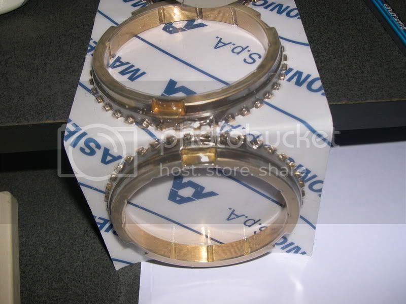

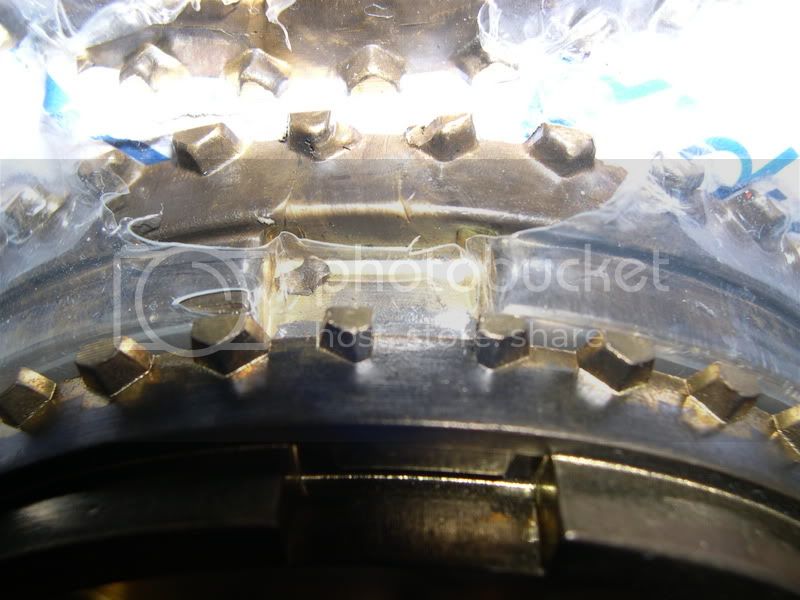

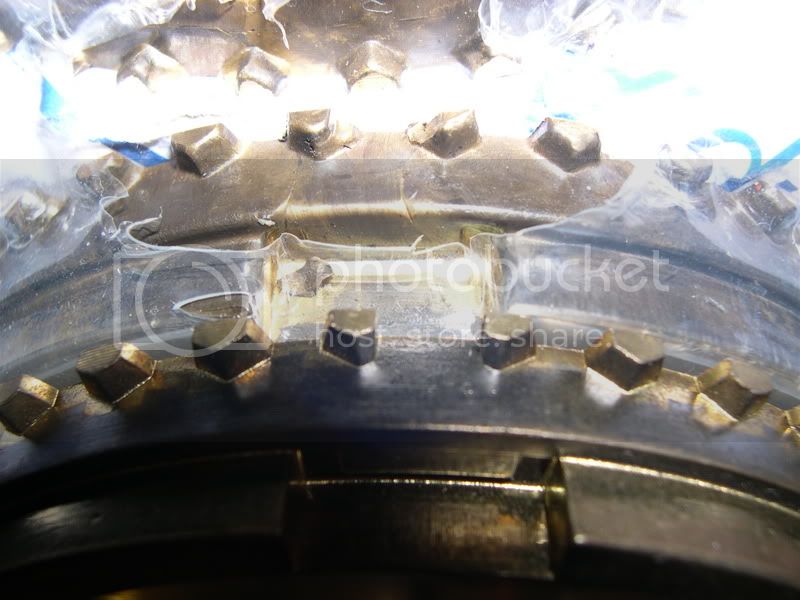

Example of badly cast new aftermarket syncro rings for H55F.
