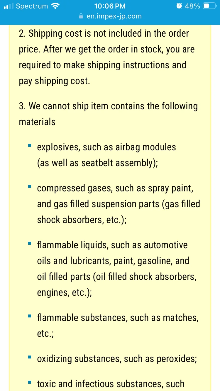

I'd go Impex Japan. ~$112 per globe. Shipping will be about another $100.
