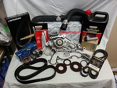

For my baseline when I bought my truck I bought this kit. It was 400 when I bought it in 2015 but inflation happens.
I picked up the parts cuz the dude Is in Costa Mesa (near me) and his store is legit nothing but jdm parts all the way to his fluids he sells.
Here is the smaller kit for just the timing belt kit
I now only buy most of my parts from him for my cruiser and my getaway car (2000 Acura TL)
