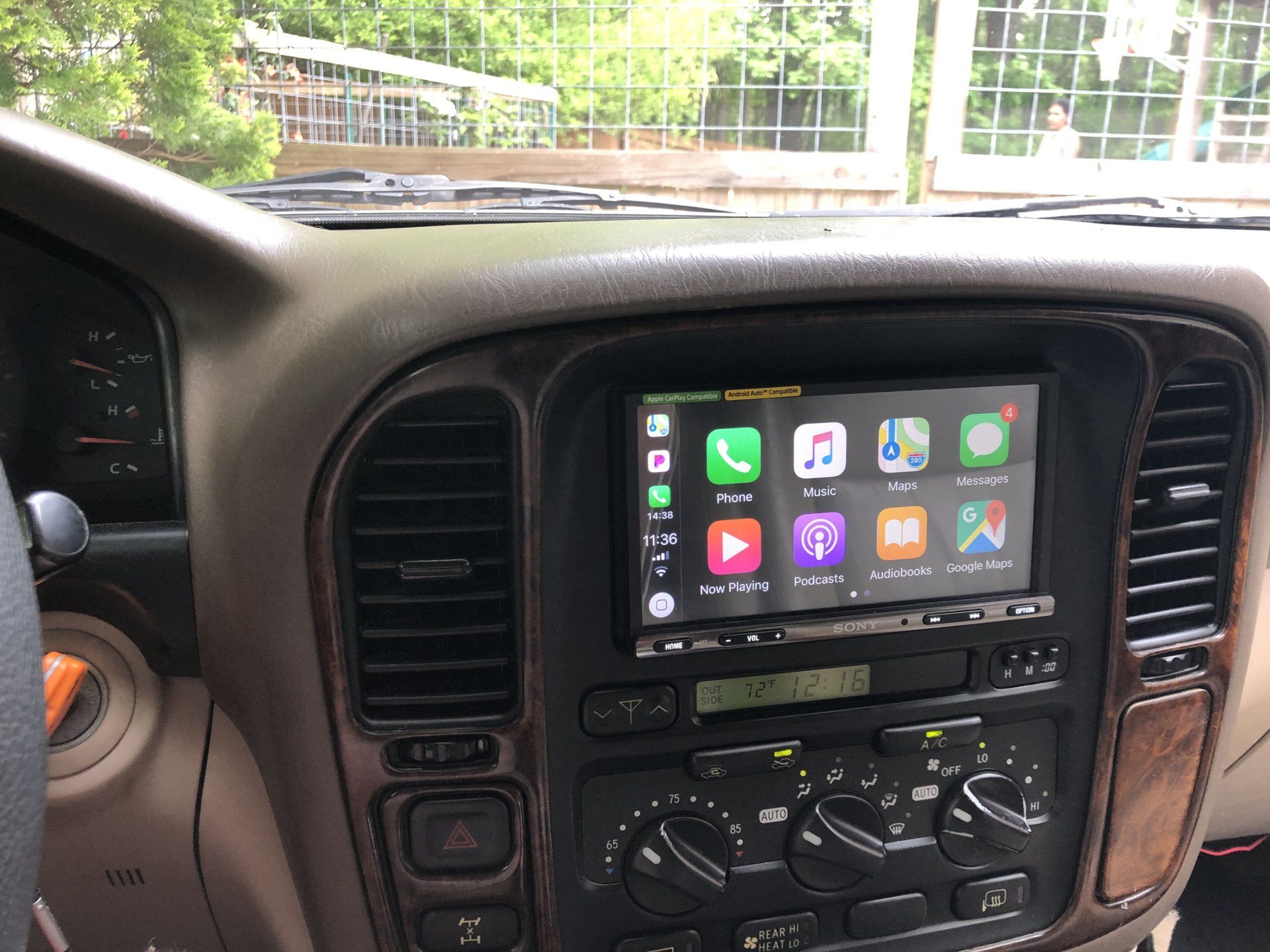

I installed a cheap $299.00 Sony Apple CarPlay radio in my 1998 LC today and am overjoyed with the transformation on the truck.
My wife has a fairly new 4Runner and I have a 200 series LC also and now the 100 is in a league of its own out front!
The 4Runner and the 200 series LC have Bluetooth streaming audio but neither have CarPlay!
I still have all the factory speakers and amp! It took 30 minutes with the kit from Clutchfield! I highly recommend this for anyone that uses google maps and props their phone on the dash while driving. My only negative is I can not play movies through it because I have not figured out how yet.
PS. I spent $335.00 delivered for everything!

The radio is a Sony XAV-AX3000, there was an adapter kit that plugged directly into the Toyota harness. The phone has to be plugged into the radio for the CarPlay.
