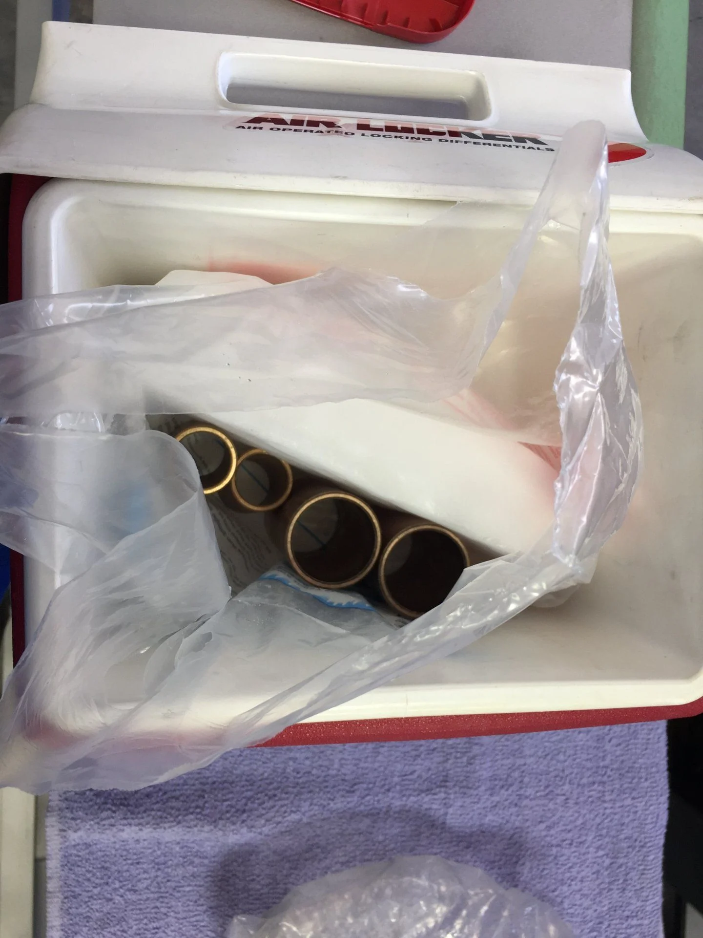

You should be able to press that in without any drama. I'd use dry ice for the bearing or just leave it in the freezer for some time. I would not heat up the DOM as I think it would work against you in this case.

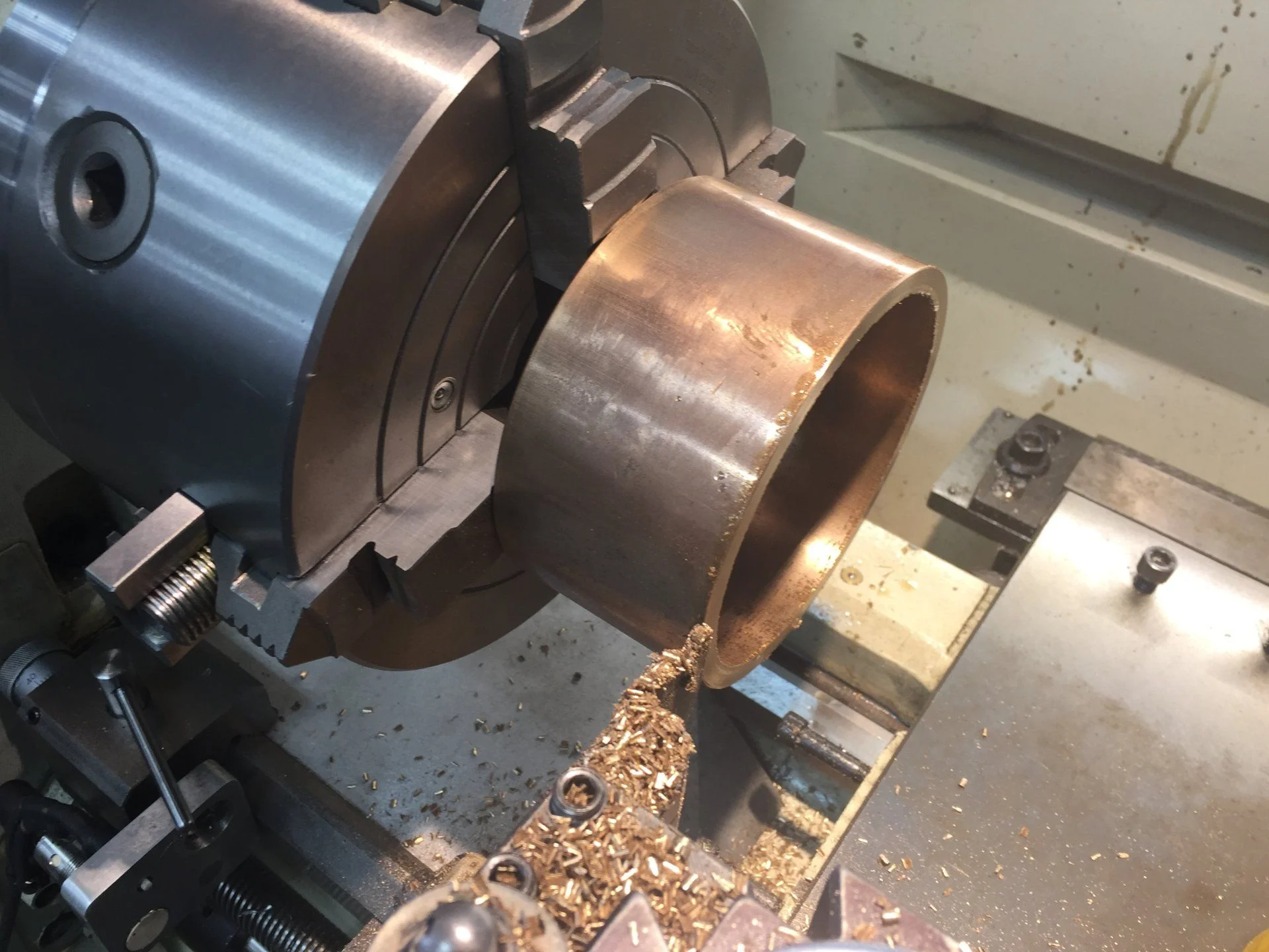

I have done some recent work/machining using Oilite. If you do find the need for turning or reaming, use sharp tooling to avoid smearing the
pours.
I prefer dry ice, it quick and easily found around here at grocery stores.

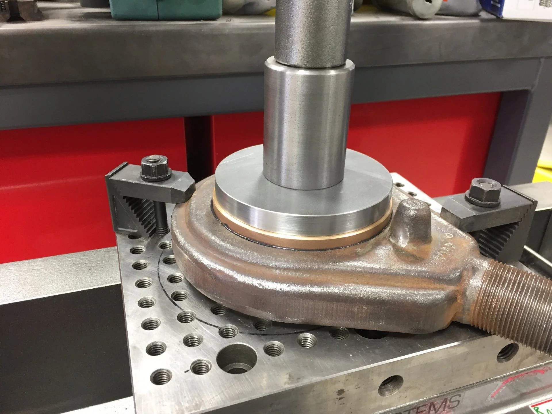

Having a lathe, I also make the correct size tooling for pressing. This will prevent any damage to the bearing.
This larger 4" olive bearing did not require freezing and was about .003" larger than the bore. The piece that rides inside the ID fit just fine. Assembly lube was the only thing used for this press (no freezing).
Machining them to tolerance requires very sharp tooling. This was a weird size bearing and very expensive, so I opted to buy a single larger piece and make the two required.

If you do find the need for turning or reaming, use sharp tooling to avoid smearing the pours.Machining them to tolerance requires very sharp tooling.
I think this the way Im planning on doing it....I have access to Dry Ice.

As far as chilling the bearing, it will shrink enough to allow pressing given your measurements. Heating the DOM will be counterproductive IMO.
Will you be using a "H" press or driving it in. The first option is always preferred.
