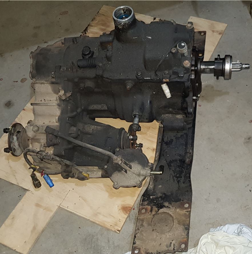

I have finally done the rebuild. Toptorque in vermont Victoria. Great people. I also had Gearbox and Transfer done by Trans Gears & Diffs in Thomas Town Victoria. Lots of Terrain Tamer parts. I am very happy
