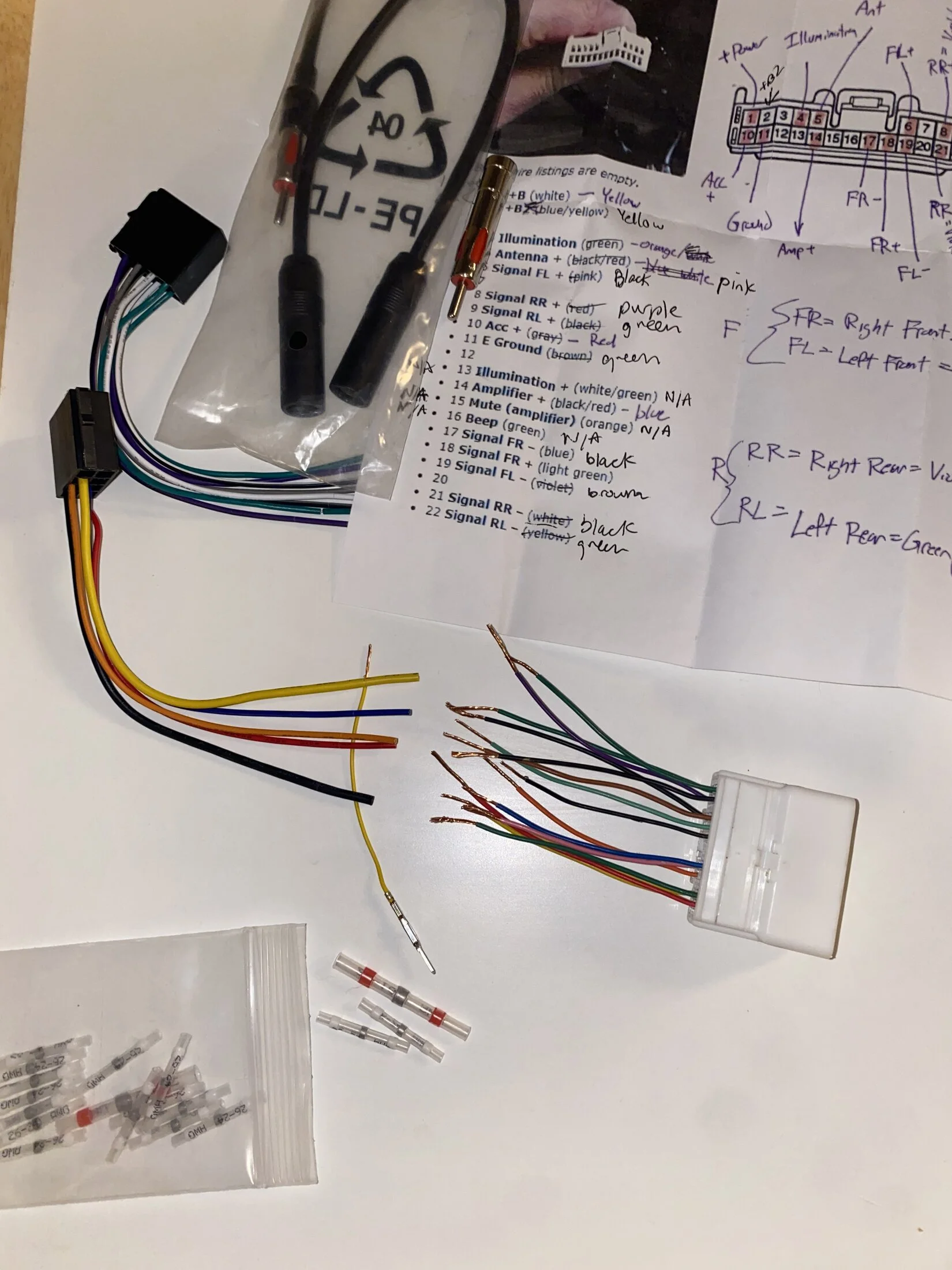

I went with nakamichi again haha. NA6605 has usb in front and 18 inch usb in back. Car play and cd player. Two other people vouched for the same model on Facebook group in their LX and that they have had no issues whatsoever for two years now since they got it. 2022 is when it came out also and a buddy of mine installs stereo units for nfl players and stated it’s a great choice. Usually $350 usd which it is now again but I snatched it up for $120 with a crazy sale. Anyway I had my harness made with 22 pin LX connector so don’t have to cut into the factory connector or harness. And I can easily upgrade units again later if I want to because I’ll have this adapter harness to work with and never have to touch factory wires and connector. FYI crutchfield or no one else in world makes one for early years lx470 with nakamichi 6 cd system, I have 99 LX.
Who made the harness? Just came across this headunit and will likely go with it for my 2000.
