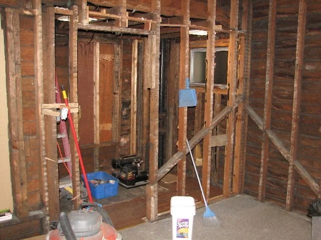

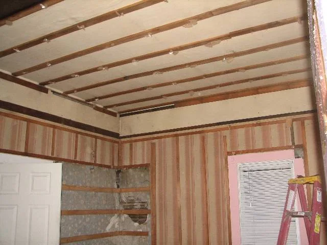

Pic 1: first layer removed.
Pic 2: Gutted - looking into bathroom
Pic 3: First window installed.

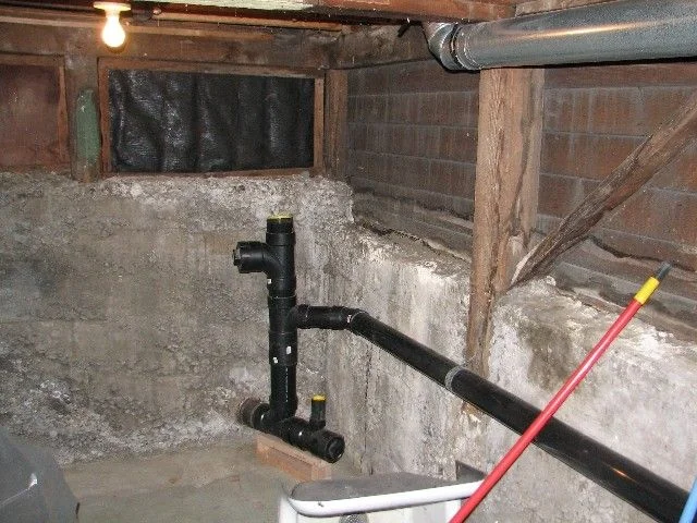

So, on to plumbing. I've removed most of the original cast iron waste pipe and tied it into the Phase 2 stuff. I'll eventually extend the stack to tie in the master bath.
Right now I am tentatively planning on going with an on-demand water heater but I'm kind of on the fence as I'm pretty sure I won't see a payback before I sell. The gas piping has become an issue as the meter needs to be upgraded from a 6" WC meter to a 2 psi model (55" WC) and then all the appliances need to be regulated. I'm thinking I'll easily spend an additional 1k to go this route.

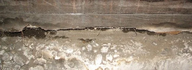

Regardless, I had to shift to the basement so I could start working on water and waste pipe. I uncovered the walls and ceiling to see what I had and this is where I have questions.
Looking at the picture, you can see (maybe) that the top of the foundation walls are basically opened to the outside. Ideally I'd like to seal everything up and I'm not sure what route to go. I will eventually frame in walls to hide all the plumbing and give a finished look.
Here's the options as I see them.
  1. Do nothing. It has been this way for years and other that a little rot, it's still in decent shape. I will probably remove the exterior siding and can fix the rot at that time.
  2. Get some concrete with epoxy, like the stuff used for leveling floors and "pour" and 2 -3 inch "footing" on top of the existing walls. Then I could add a treated sill and tie in the exterior siding.
  3. I could also dig out the dirt on the outside so grade level is below the foundation. There is about 3 - 4 feet from the house to the neighbors property and that area is paved with 12" square concrete bricks. I could pull up all the bricks, remove a couple inches of dirt, and put everything back.

Open to the outside? Are you refering to the black tar paper straight ahead -vs- the block wall coming off the footing to the right?
You just want to fill in where the tar paper is?
I think the foundation wall is above ground level where the tar paper is so I really don't think that spot is a problem. On the other wall that is dirt sitting on top of the foundation. You can also see a couple different water lines on the boards going up. This is my concern. I also take on a little water there during really heavy rains.
So basically you can slide your hand between the top of the foundation and the bottom of the siding and reach outside.
Here's a close-up.
Ok you can kinda see it. You said you believe the footing is above grade. If that is the case then you can do two things.
First (regardless of whether or not your going to reside the entire house) you can remove just the lower planks across the bottom few runs and flash it off properly using galvanized flashing material (can pick it up in rolls ranging in 4" to 12"+ height having a length anywhere from 25' to 100'+). Just slide the flashing up under the vapor barrier and nail/screw it off leaving a few inches to hang down past the footing. I also like to dab some caulking over the nails/screws to help seal it up. Replace your bottom rows.
Even if the existing siding terminates on top of the footing wall you can bend the angle to fit properly over the footing and down the side thus eliminating any moisture from coming in. Side note try no to put a 90 degree angle in a bend if the footing extends past the siding. Leave a slight angle to allow water to fall off properly.
Second you might consider a french drain around that area to quickly alleviate water from forming and flooding up behind the flashing, depending on the overall height of the footing wall.
Last thing is once the flashing is in place take some expandable polyurethane foam and shoot a little (key word "little") to help seal up any air gaps. You just don't want to push the flashing away from the side of the house.

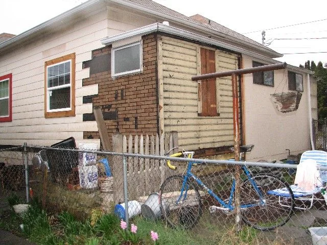

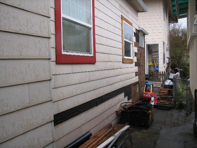

Got about 5 hours in on Sunday. Started removing siding for the foundation repair and the window installation. It's a slow process trying to get the tiles off without breaking them, but I've gotten pretty good at it since I've replaced almost all the windows now. Then there is the layer of fake brick before getting to the original cedar.
I plan to hit it hard this Friday and Saturday. We'll see how things go.

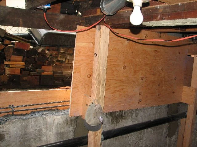

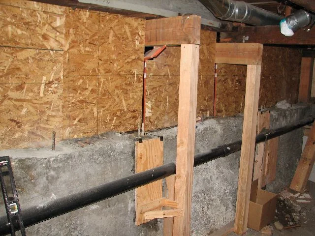

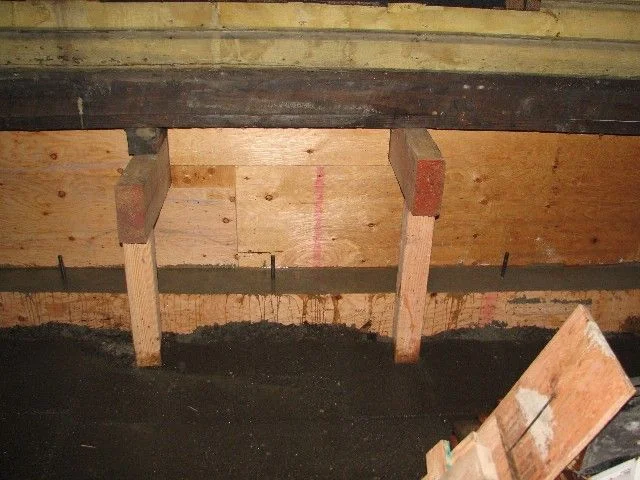

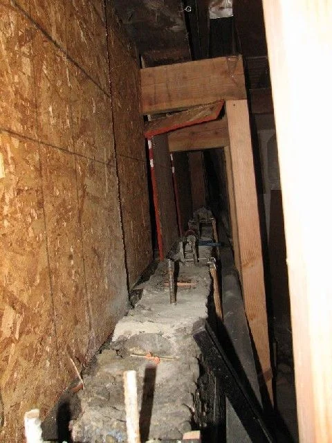

Lot accomplished today - worked for about 14 hours. Started out by clearing some space in the basement and getting some plastic up to keep the dirt out of the rest of the basement. Then I moved outside and removed all the necessary siding.

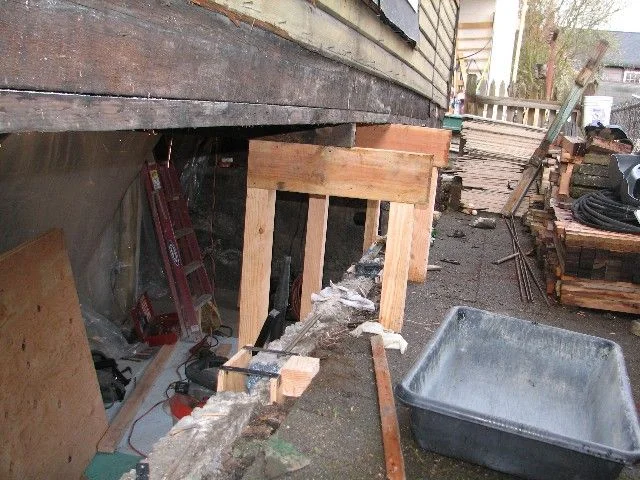

Next was the jacking of the house, removal of the rotten posts, and temporary supports. This all went surprisingly well. I decided to pour the concrete in the post holes first and then add the footing tomorrow. This was a pretty tedious process of cleaning the concrete, applying a bonding agent (Weldcrete) and getting the forms all set. After about fours hours of this, I finally had the concrete in the holes.
After that, I started drilling. I drilled four holes in the foundation, applied some Simpson SET epoxy and put in some rebar. This will tie everything into the existing foundation. Tomorrow I'll string some rebar horizontally.
I finished off by nailing some OSB to the outside of the house to seal everything up for the night.
Pic 1: this is what was supporting my house.
Pic 2: First support.
Pic 3: Supported and forms in place.

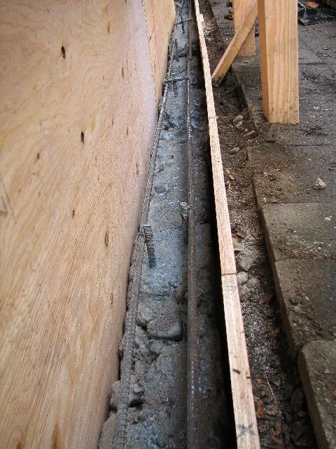

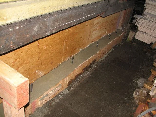

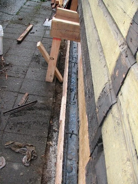

Another busy day - put in about 10 hours. Lots of little stuff to do to get everything ready to go. I pulled the forms from yesterday and then decided I needed to clean out a path in the basement because I had crap scattered all over my small work area. Of course by the end of the day, it was pretty much back to the way it started.
I then got to work getting the outside forms ready. I trenched out about six inches along the foundation so I could set the forms there and then backfill with dirt so they would be rigid. I established the height and cut the form and did a temp fit to make sure it was going to work.
Then the fun job of cleaning the top of the foundation for the Weldcrete. Vacuum, scrub brush, water, and vacuum again. Came out really clean - way better then the post holes I did the previous day. Applied the Weldcrete and started tying up the rebar.
I went ahead and did the final setting of the outside forms and backfilled. For the inside I wanted to attach at the bottom plate of the first floor floor joist. This was done for two reasons, first there was nowhere else to attach and second it seals off the house from outside. Added a few braces at various locations and I was ready to pour concrete.
I'm still kicking myself for not buying a cheap mixer but 16 bags of concrete later, I was done - almost. I troweled the surface and installed some anchor bolts. The bolts are probably a little overkill but it's what the concrete store had. Plus I bought to many so I spaced them pretty close.
A little clean up and I was done for the evening. I still have to clean up my mess and haul the scrap to the dump. I think I'm going to leave the forms until next week, unless it's bad to leave the forms on too long. I have to clean up the basement a little so I can hook the dryer back up. Can't go a week in this house without a dryer. Then next week I'll put in the wall and set the house back down.
Some pictures for your viewing pleasure.
Tom
I went ahead and pulled the outside forms today and pulled the inside ones off the footing. I added some spacers between the wall and forms on the inside and put all the braces back. This will be my exterior wall until next week when I build a new wall.
